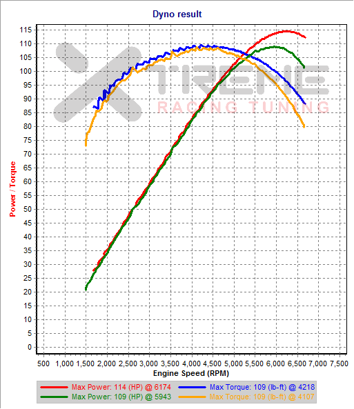

v0 vs Another Tuner Based Map - 2nd Gear Dyno SAE vss

XRT Curve - Red/Blue
v0 vs Kido - 2nd Gear Dyno SAE vss.png (21.62 KiB) Viewed 15856 times

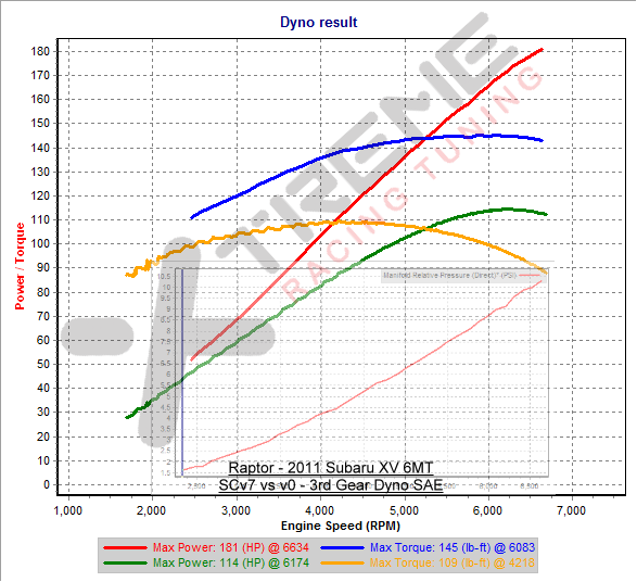

SC Tuning
High Flow Exhaust, 2.5"
Supercircuit Headers
High Flow CAT

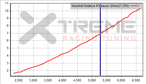

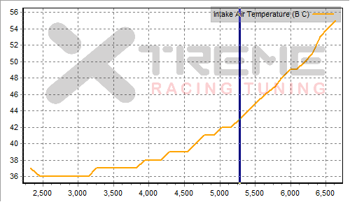

SCv7 - 3rd Gear ACT.png (11.61 KiB) Viewed 15182 times
SCv7 vs v0 - 3rd Gear Dyno SAE.png (59.83 KiB) Viewed 15182 times
