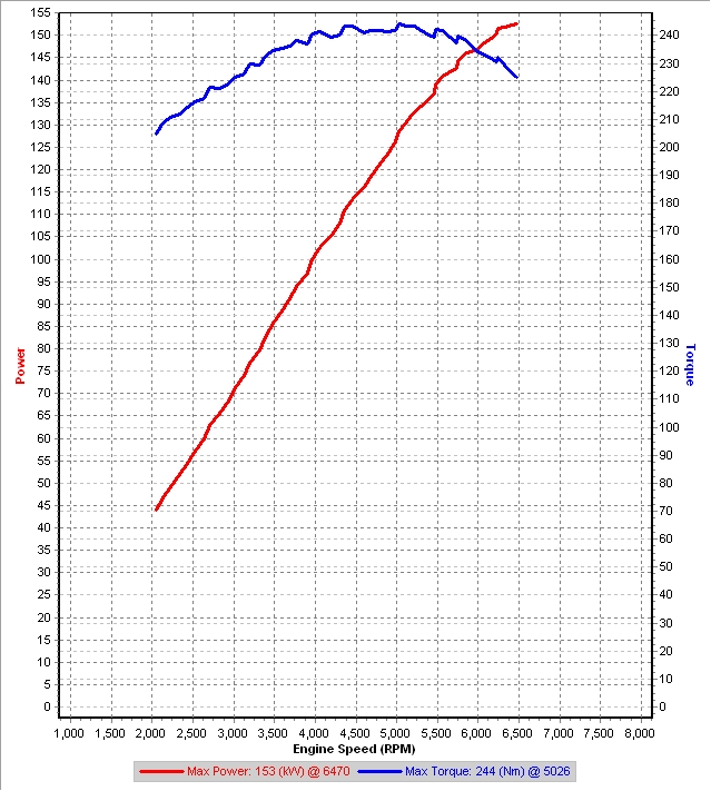

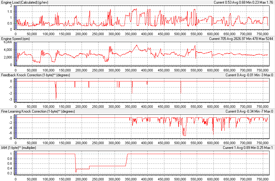

V0 Driving Stats. Finding rom completed.
- Attachments
- v0 Driving Stats.png (24.96 KiB) Viewed 15990 times

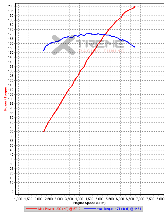

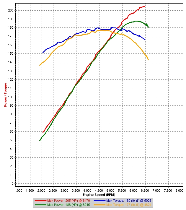

V0 Dyno Stats
Higher or Blue/Red lines are v0 dyno'es.
Fueling is still close to 14.7AFR before the car shifts to Normal mode. Once this can be rectify, I will see if the torque will come up before 2500rpm. AVCS has not be adjusted yet and will not be until the fueling is finished.
Some dyno runs were affected a bit due to ignition being pulled due to pinging and maybe old spark plugs.

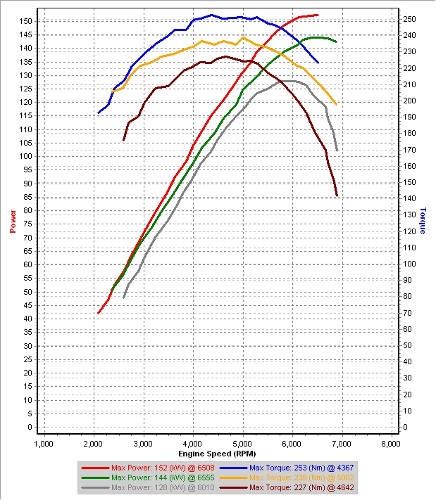

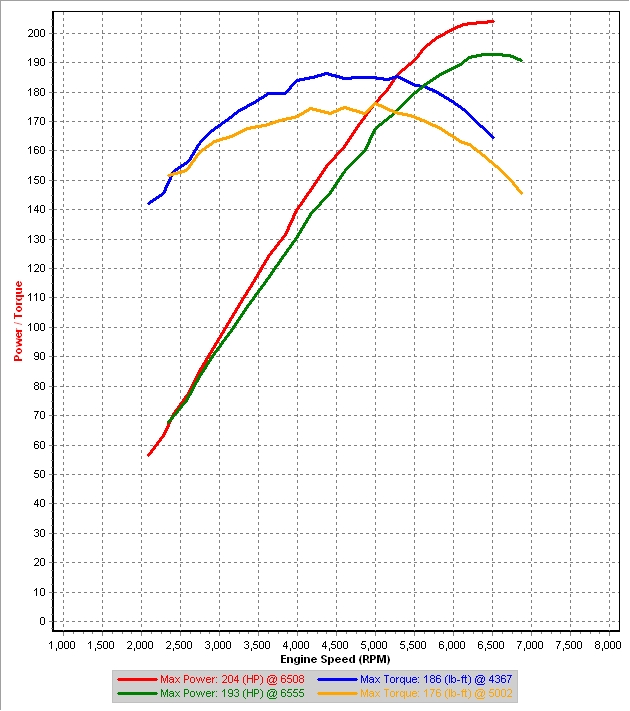

Re: 2005 ADM Subaru Liberty 3.0R Spec B 6MT - Tuning Process

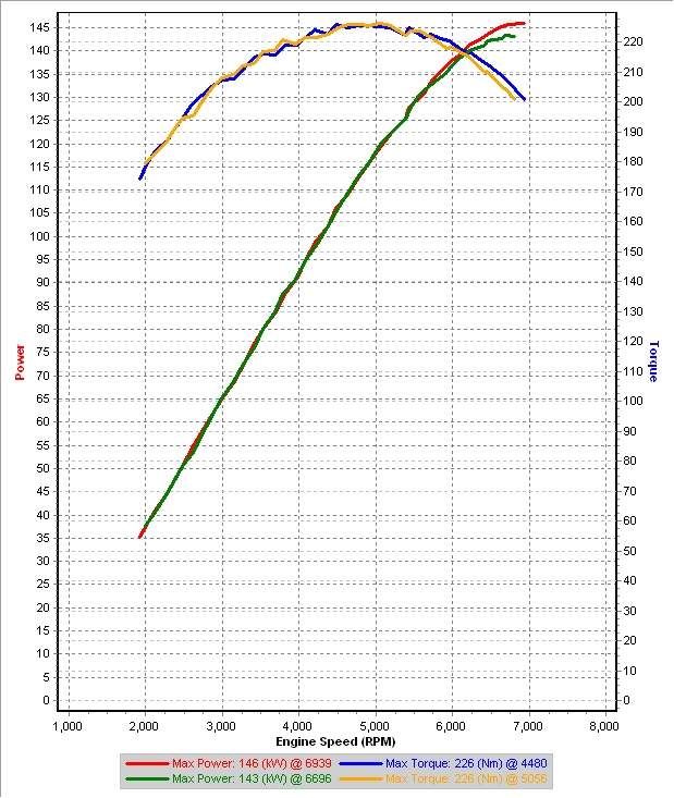

Dynoes in KW and Nm
Software dyno'es based on rpm. Speed dyno's are 10units less.
v0 vs stock mod vs stock - 3rd Gear Dyno's comparison
v0 vs stock mod vs stock - 3rd Gear Dyno's comparison @ Temperatures less than 24C
- Attachments
- v0 vs Stock mod vs stock - 3rd Gear Dyno #1.png (82.25 KiB) Viewed 15984 times

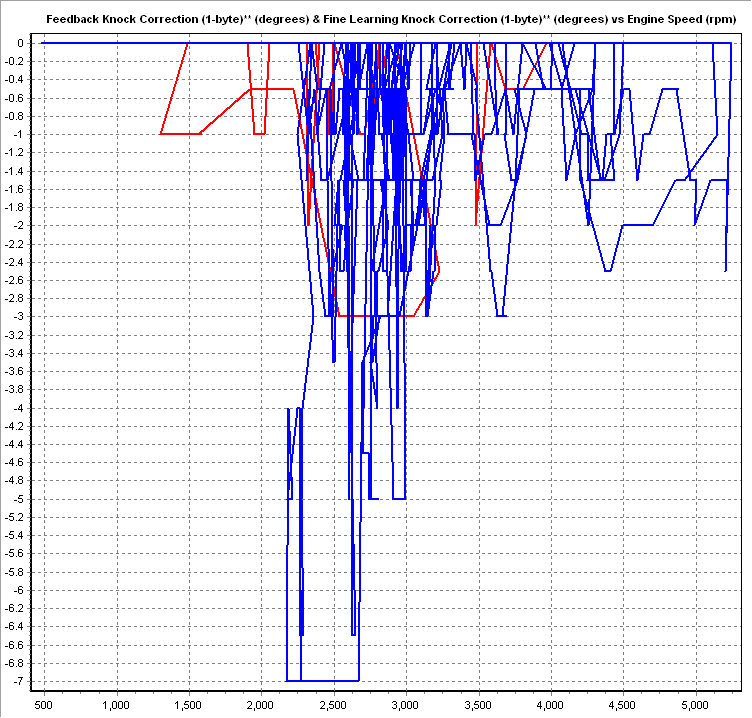

v1 Driving Stats
v1 Driving Stats
- Attachments
- v1 Driving Stats - FLKC FKC.png (26.99 KiB) Viewed 15983 times
- v1 Driving Stats.png (24.29 KiB) Viewed 15983 times

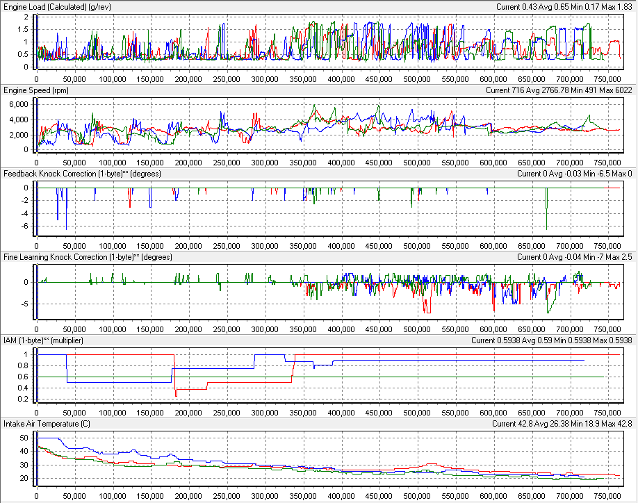

V1 vs V0 vs Stock Driving Stats
Heat really affect NA engines quite a bit. A CAI is really needed, including keeping the air cool enough until it reach the engine. Water Injection is really needed
- Attachments
- V1 vs V0 vs Stock Driving Performance.png (39.66 KiB) Viewed 15983 times

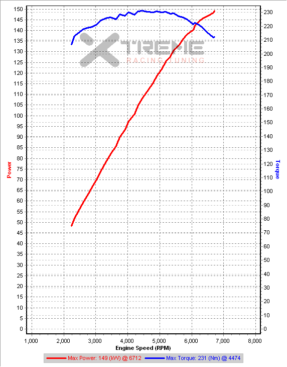

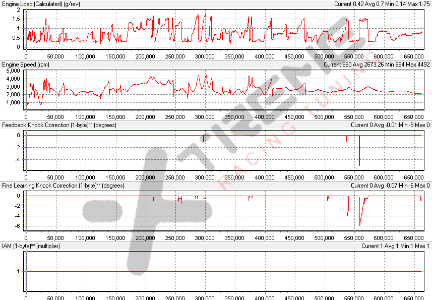

v3 Stats
Temperatures greater than 29C to 41C
- Attachments
- v3 3rd Gear Dynos kw.png (25.22 KiB) Viewed 15980 times
- v3 3rd Gear Dynos.png (21.33 KiB) Viewed 15980 times

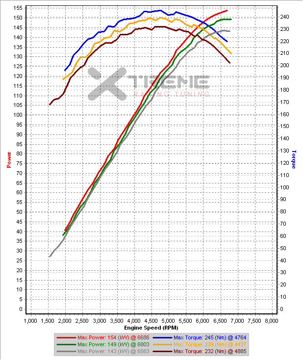

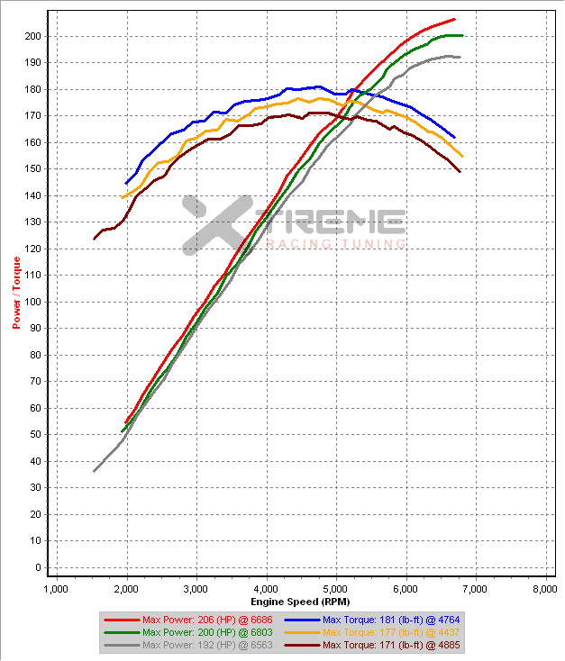

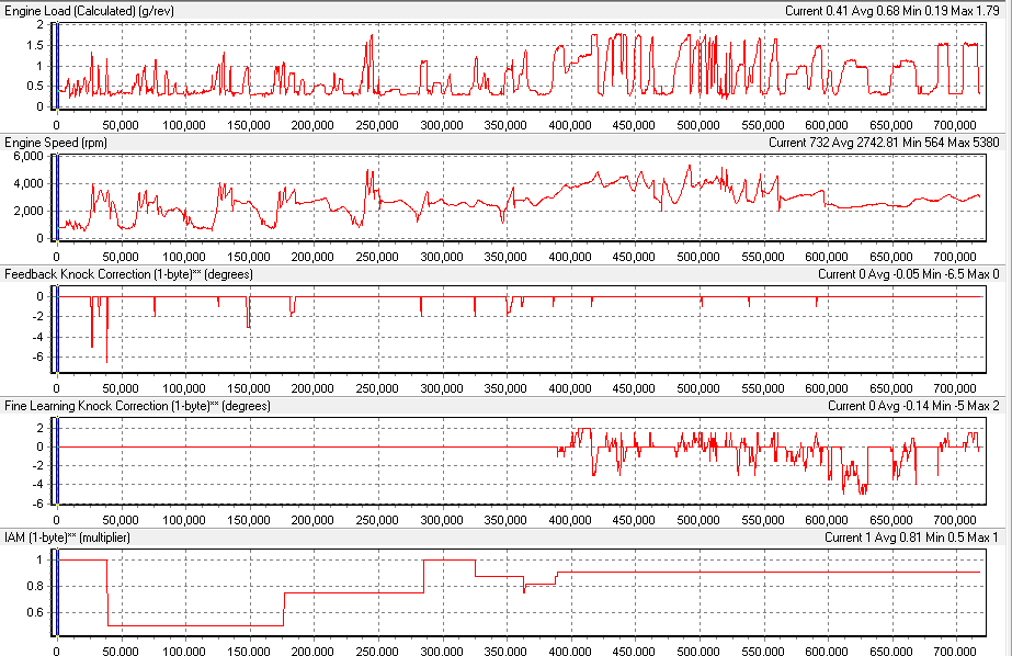

v4a Stats
v4a Stats
v4a 3rd Gear Dynos - IAT=30.5C to 31.5C
