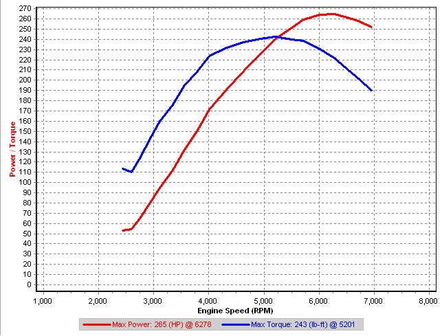

No Mods
Car running mix gas - race gas added
Max boost was 18psi
IAM jumping from 8 to 10
2003 Subaru Impreza WRX/STI non-twinscroll - Stock
- Attachments
- Dyno - Pump_Race Gas mix @ IAT44C 18psi.png (10.93 KiB) Viewed 7233 times
