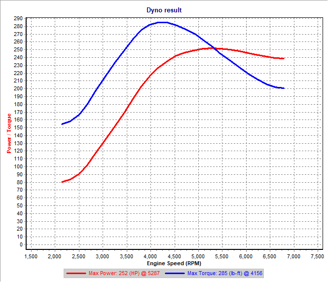

Old Tuned - 4th Gear Dyno SAE
Old Tuned - 4th Gear Dyno SAE.png (21.22 KiB) Viewed 13028 times

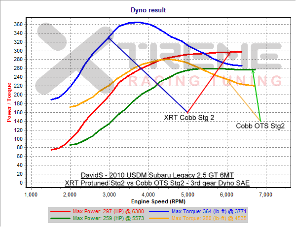

XRT Protune Stg2 vs Cobb OTS Stg2 - 3rd Gear Dyno SAE
v7c - XRT vs Cobb Stg2 3rd Gear Dyno SAE.png (39.75 KiB) Viewed 13028 times

It was my pleasure to work with Ed to tune my 2010 Legacy GT via a cobb protune. Ed is a genius when it comes to Subaru calibration, and can help you get the most out of your car as a daily driver, or a built specialty car. As a guy when has never protuned before it was great to have a patient teacher to help me understand my car and how to get the most out of it.
I highly recommend XRT
