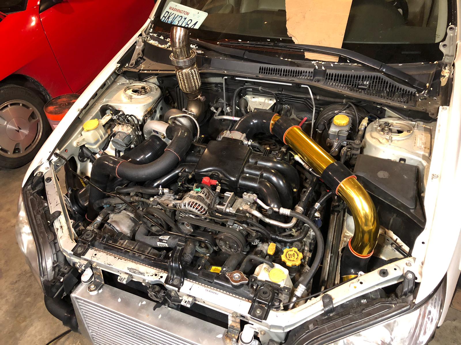

XRT EZ30 NA Turbocharged Tuning
XRT 5EAT Tuning
Raptor headers
Custom up pipe,
Holset HX35 turbo with hood dump exhaust
Tial 38mm wastegate with 10 lb springs installed,
No BOV
3.6R MAF sensor
Omni 4 bar MAP sensor
24”x12”x3.5” fFMIC
ID1050x injectors for WRX
Aeromotive 325 Fuel pump
