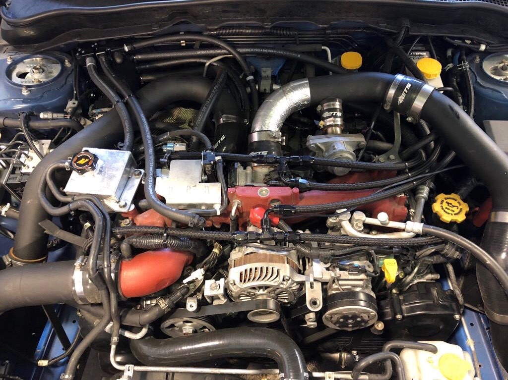

Cobb AP v3

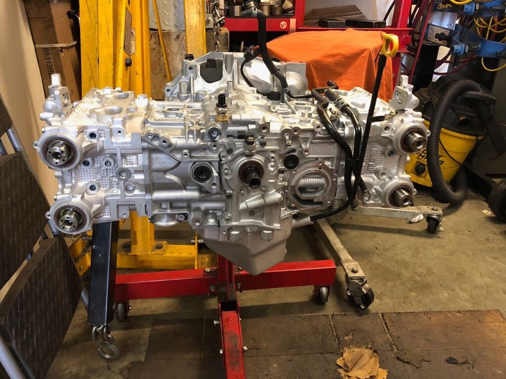

IAG stage 2 tuff shortblock - https://www.iagperformance.com/IAG-Stag ... g-1211.htm
Stock serviced heads
ID1000cc injectors
DW65c fuel pump
Cosworth fuel rail - https://www.iagperformance.com/Cosworth ... 026741.htm
Parallel routing of fuel lines
COBB Fuel Pressure Regulator
Air Pump delete
Evap delete
IAG tgv deletes
APS aluminum turbo inlet (APSWRX-CID/01)
ETS 3” intercooler
ETS 3" Intake
ATP GT3071 - http://www.atpturbo.com/mm5/merchant.mv ... y_Code=BCS
Grimmspeed EBCS
Tomei headers
HKS Bellmouth downpipe
44mm Tial external wastegate
IAG Air Oil separator - https://www.iagperformance.com/IAG-Stre ... g-7151.htm
ACT street-lite flywheel 15lbs

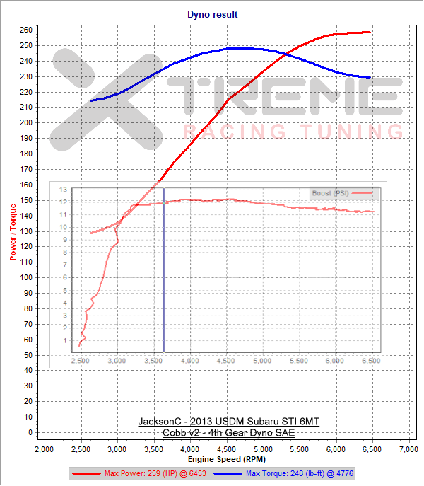

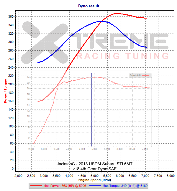

v2 & v18 - 4th Gear Dyno SAE
v2 4th Gear Dyno SAE.png (54.19 KiB) Viewed 17645 times
v18 4th Gear Dyno SAE.png (48.35 KiB) Viewed 17407 times

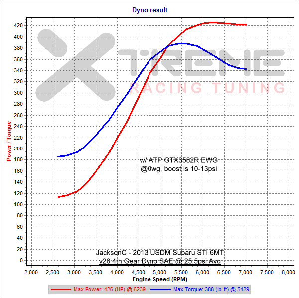

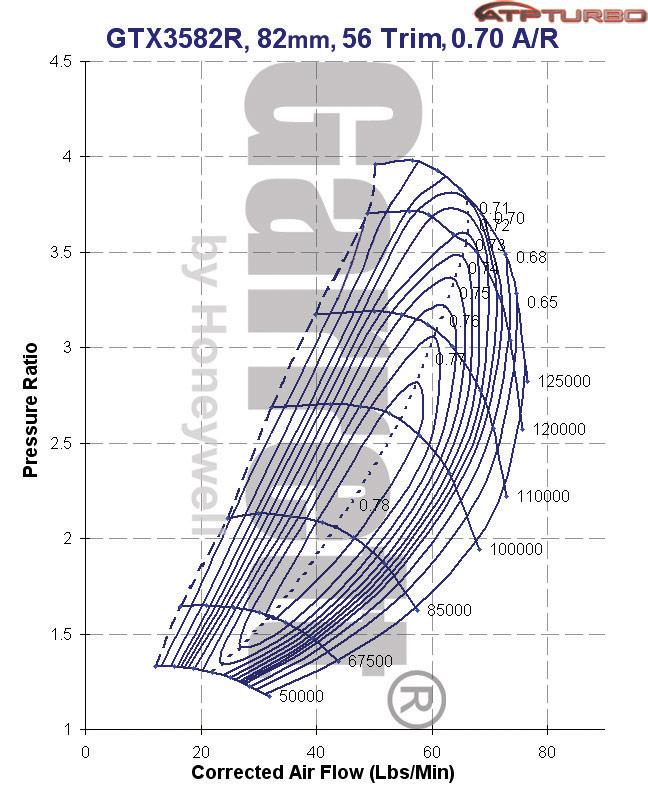

Turbo been upgraded to an ATP GTX3582r EWG exhaust housing
Compressor Wheel: Ind: 62.5mm
Exd:82.5mm
Turbine Wheel: 68.00mm
Turbine A/R for Subaru Stock Location: .72 a/r
Compressor A/R for Subaru Stock Location: .60 a/r
https://www.atpturbo.com/mm5/merchant.m ... y_Code=SUB
v28 4th Gear Dyno SAE @ 25.5psi avg
v28 4th Gear Dyno SAE @ 25.5psi.png (35.31 KiB) Viewed 17395 times
