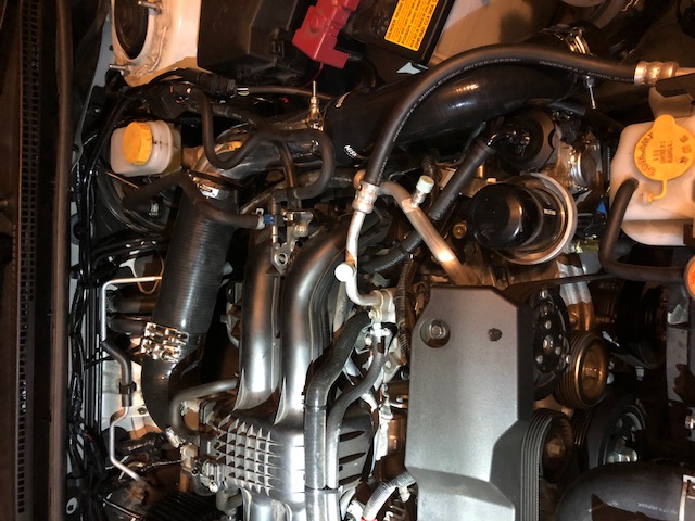

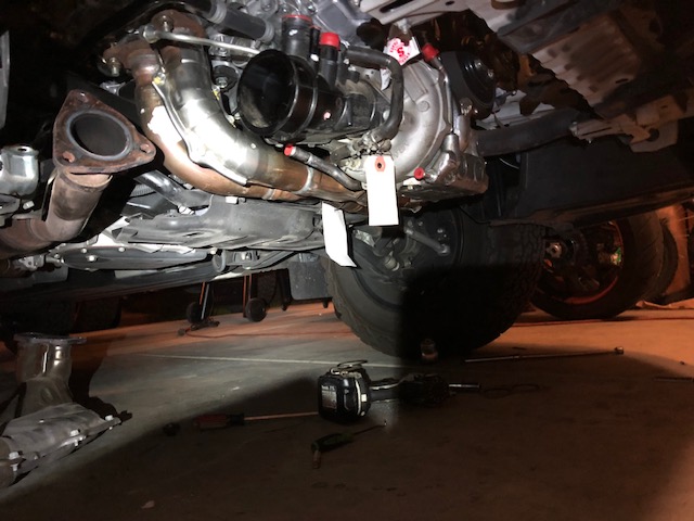

Prefab used turbo and manifold from FA20DIT
bolted right up just had to move the center bolt holes over about 8MM and use some redneck engineering to put a couple small dents in the oil pan

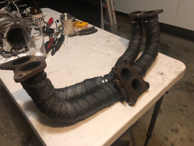

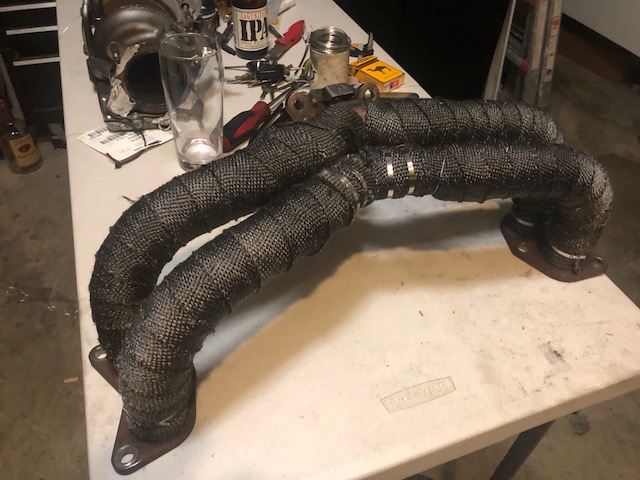

Heat shields removed due to clearance issues, and heat wrapped.

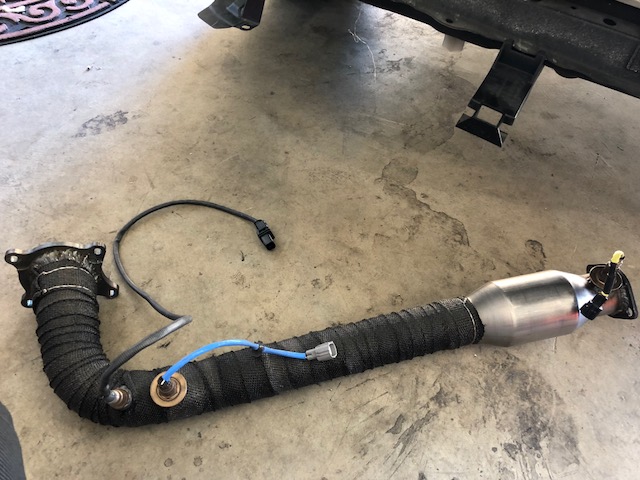

down pipe fabricated and mounted in the car. I used a high flow cat and OEM O2 sensors. I also added a Innovative wide band O2

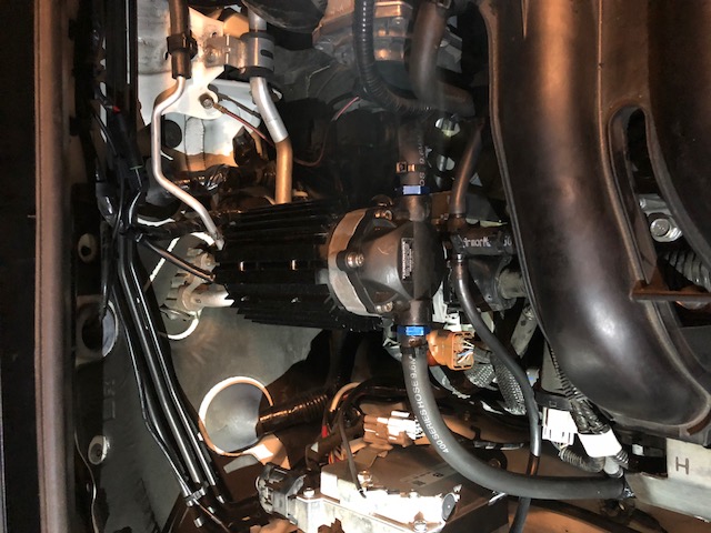

Turbowerx oil pump used to scavenge oil from low mount turbo sump, I chose to use a cheap aluminum oil cap and drill it as the return. I also fabricated a bracket to support the pump that bolts
to the engine hoist bracket

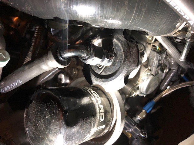

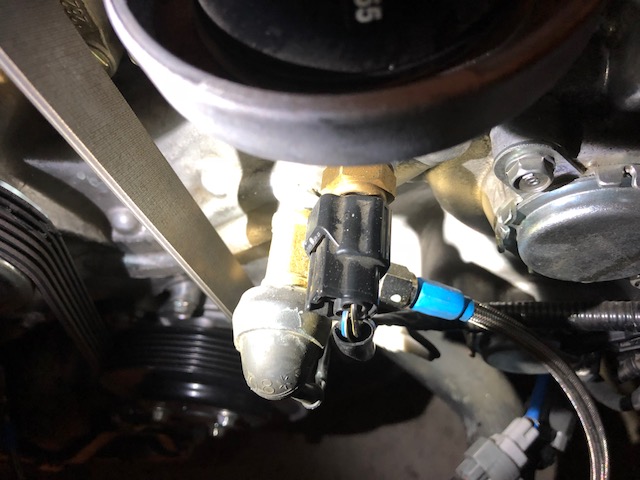

turbo oil supply can be teed off of the oil pressure sensor
