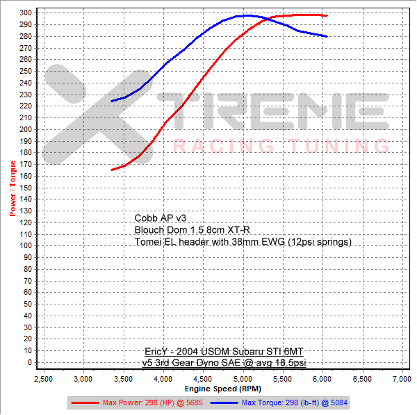

v5 3rd Gear Dyno SAE @ 18.5psi
v5 3rd Gear Dyno SAE @ 18.5psi.png (37.12 KiB) Viewed 15854 times

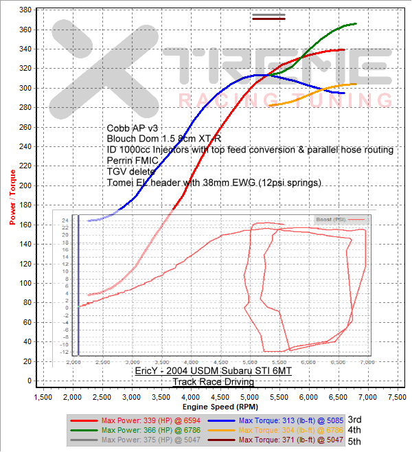

v13 Race Pulls - Dynoes
v13 Race Pulls Power.png (100.61 KiB) Viewed 15809 times

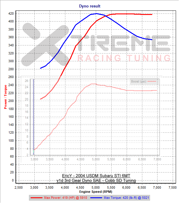

v1d 3rd Gear Dyno SAE
v1d 3rd Gear Dyno SAE.png (55.4 KiB) Viewed 15514 times
