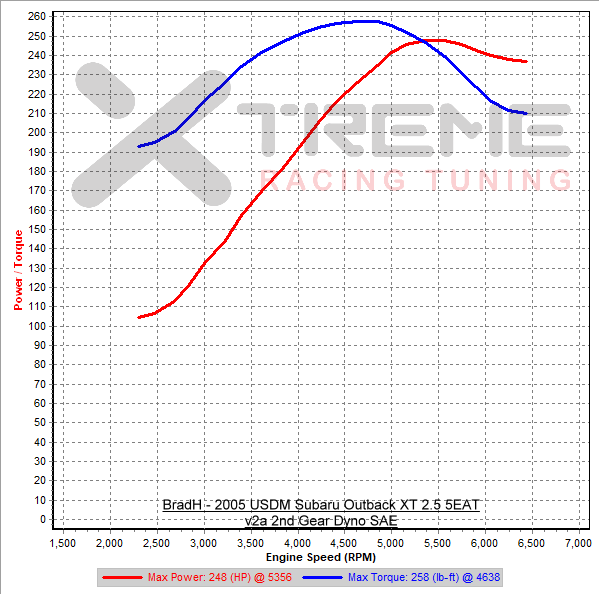

BradH - 2005 USDM Subaru Outback XT 2.5 5EAT - Tuning
Owner: BradH
Rom: A2WC510R
Tyres: 215/65R17
Car Weight: 1588kg
Driver Weight: 77kg
Total Weight: 1665g
XRT Stg2
XRT 5EAT
Stock but the new short block has NPR forged pistons (99.5mm) and ARP rod bolts, ARP head studs
Grimmspeed crossover pipe between the manifolds
TGV's are deleted
3" CNT Catless downpipe
Stock mid/resonator and no mufflers.
v2a 2nd Gear Dyno SAE
v2a 2nd Gear Dyno SAE.png (29.94 KiB) Viewed 7940 times
