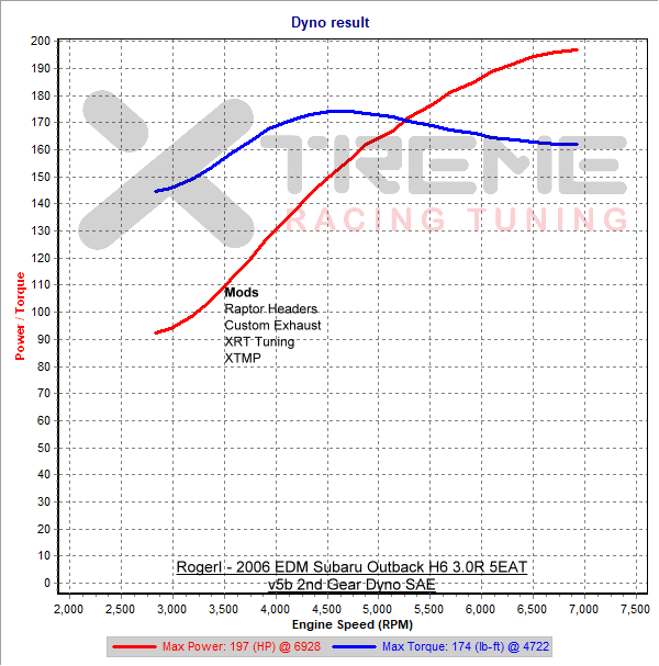

Owner: RogerI
Rom: D0XJ001R
Tyres: 225/40 R18
Car Weight: 1606kg
Driver Weight: 84kg
Total Weight: 1690kg
https://www.facebook.com/XtremeRacingTu ... 6998088154
Custom Exhaust
XRT Tuning
XTMP
v5b 2nd Gear Dyno SAE
v5b 2nd Gear Dyno SAE.png (34.23 KiB) Viewed 21633 times

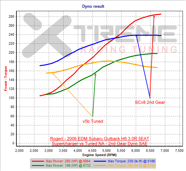

Supercharger vs Tuned NA - 2nd Gear Dyno SAE.png (40.55 KiB) Viewed 21026 times

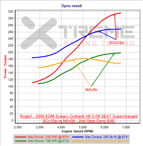

SCv10a vs NAv5b - 2nd Gear Dyno SAE
SCv10a vs NAv5b - 2nd Gear Dyno SAE.png (31.69 KiB) Viewed 20989 times
