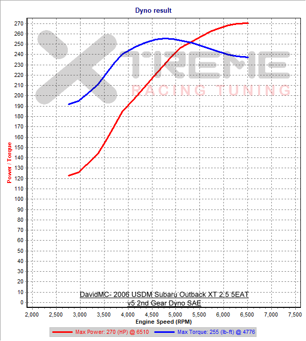

DavidMC- 2006 USDM Subaru Outback XT 2.5 5EAT - Tuning
Owner: DavidMC
Rom: A2WF200R
Tyres: 225/55-R17
Car Weight: 1624kg
Driver Weight: 102kg
Total Weight: 1726kg
XRT Stg2
XRT 5EAT
Grimmspeed catless up-pipe
BNR 16g turbo
K&N filter

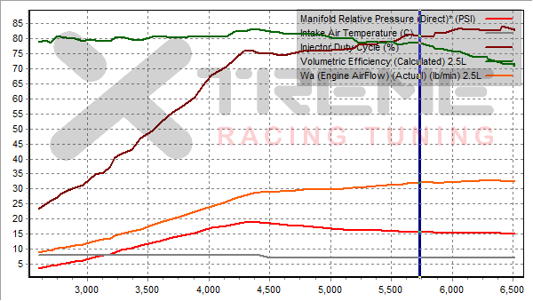

v5 2nd Gear Dyno Stats
v5 2nd Gear Dyno SAE.png (31.25 KiB) Viewed 7718 times
v5 2nd Gear Dyno Stats.png (19.03 KiB) Viewed 7718 times
