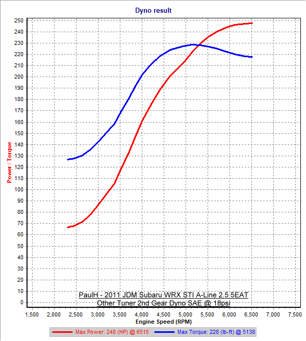

Other Tuner - 2nd Gear Dyno SAE
Posted: Mon Jan 29, 2018 4:48 pm
JimmyTuner - 2nd Gear Dyno SAE.png (30.02 KiB) Viewed 17683 times

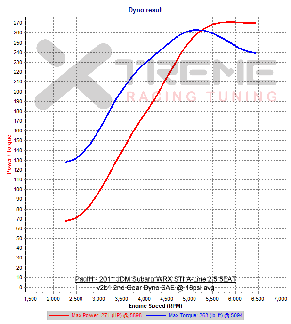

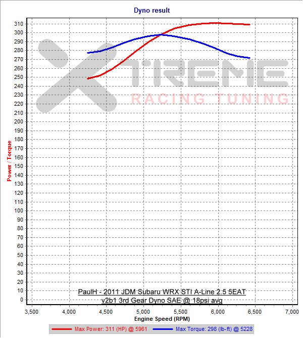

Re: PaulH - 2011 JDM Subaru Impreza WRX STI A-Line 2.5 5EAT
Posted: Sat Feb 03, 2018 6:01 pm
I am still dialing in the boost curve.
v2b1 2nd gear Dyno SAE.png (33.33 KiB) Viewed 17682 times
v2b1 3rd gear Dyno SAE.png (30.07 KiB) Viewed 17682 times

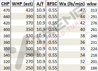

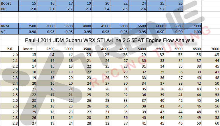

Engine Follow Analysis
Posted: Mon Feb 05, 2018 9:33 am
A-Line Flow Analysis.png (76.26 KiB) Viewed 17657 times
A-Line Flow Analysis Power.png (17.16 KiB) Viewed 17657 times

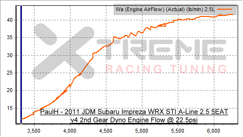

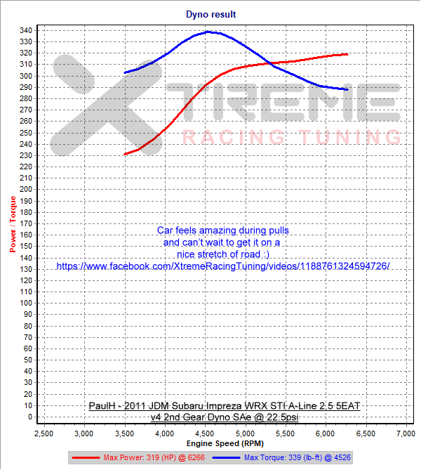

v4 Results
Posted: Tue Feb 06, 2018 9:08 pm
v4 2nd Gear Dyno SAE @ 22.5psi.png (44.83 KiB) Viewed 17649 times
v4 2nd Gear Dyno Wa @ 22.5psi.png (19.35 KiB) Viewed 17649 times
https://www.facebook.com/XtremeRacingTu ... 324594726/
Car feels amazing during pulls and can’t wait to get it on a nice stretch of road
https://www.facebook.com/XtremeRacingTu ... 6248298567
The car is now feeling much better than I imagine, it moves and feels GREAT threw out the entire power-band, no more waiting till after 5000rpms to feel being pushed back in the seat. XRT is the best in customer service, turn around time and great advisor and tuner. Turn the car from slouchy to speedy
