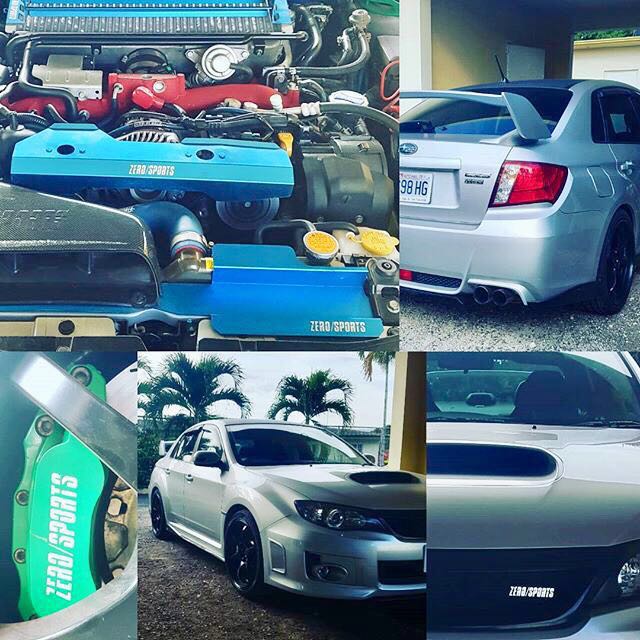

PaulH - 2011 JDM Subaru Impreza WRX STI A-Line 2.5 5EAT
2001+ Subaru STI
Owner: PaulH
Rom:AZ1G800F
Tyres: 245/35-19
Car Weight: 1490kg
Driver Weight: 111kg
Total Weight: 1501kg
XRT Stage 2
XRT 5EAT Tuning
Zero Sports intake
Decatted downpipe
Zero Sports exhaust
Zero Sports pulley kit
Grimspeed EBC
Turbo Heat shield and blanket
Blouch 20G XTR (8cm) (47lb/min|480CHP)
ID 1050X
DW Fuel pump
TGV Deletes

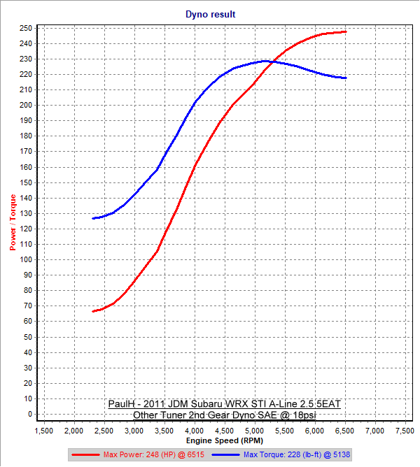

Other Tuner - 2nd Gear Dyno SAE
JimmyTuner - 2nd Gear Dyno SAE.png (30.02 KiB) Viewed 18480 times

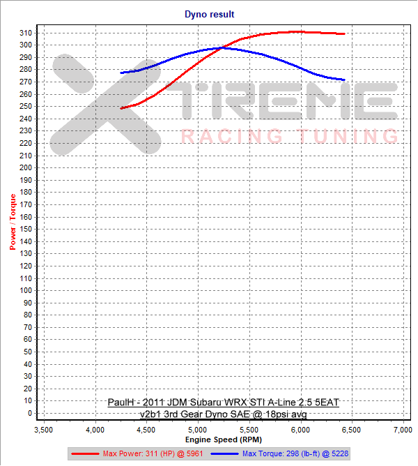

I am still dialing in the boost curve.
v2b1 2nd gear Dyno SAE.png (33.33 KiB) Viewed 18479 times
v2b1 3rd gear Dyno SAE.png (30.07 KiB) Viewed 18479 times

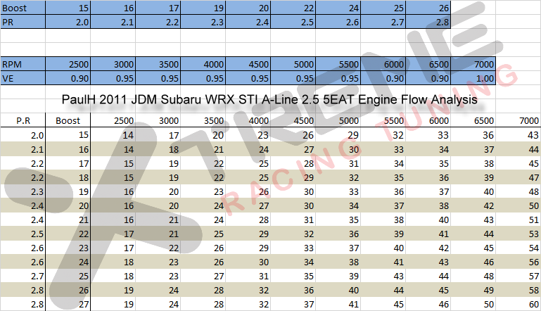

Engine Follow Analysis
A-Line Flow Analysis.png (76.26 KiB) Viewed 18454 times

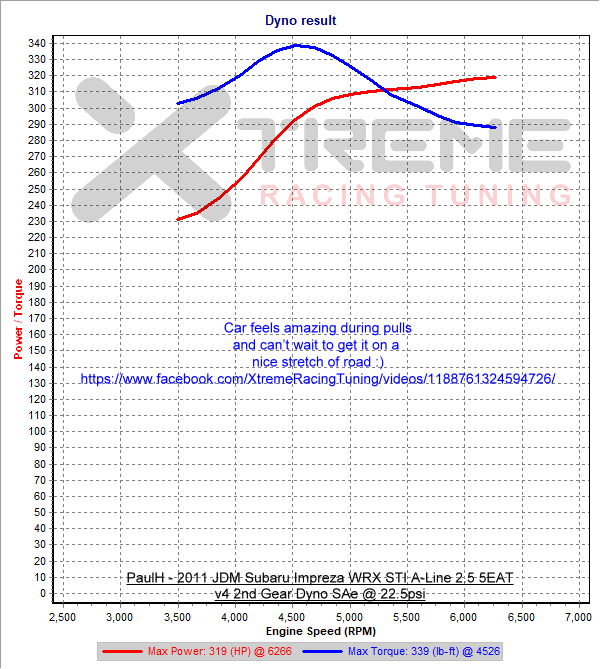

v4 Results
v4 2nd Gear Dyno SAE @ 22.5psi.png (44.83 KiB) Viewed 18446 times
v4 2nd Gear Dyno Wa @ 22.5psi.png (19.35 KiB) Viewed 18446 times
https://www.facebook.com/XtremeRacingTu ... 324594726/
Car feels amazing during pulls and can’t wait to get it on a nice stretch of road
