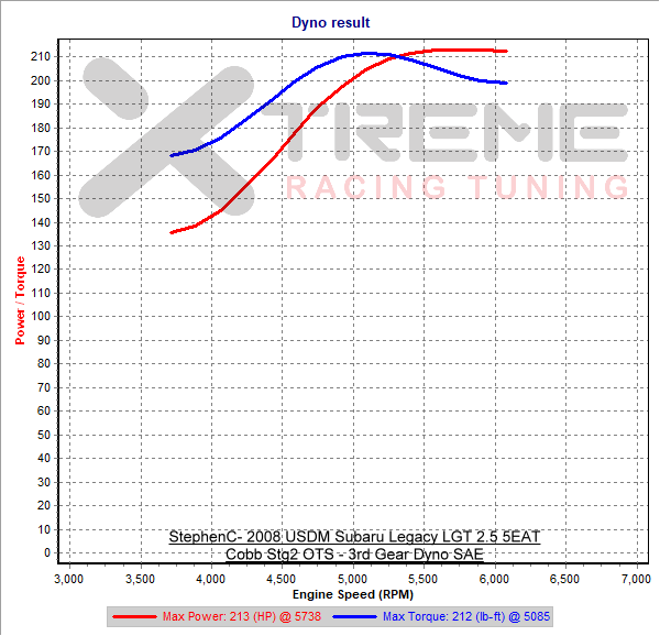

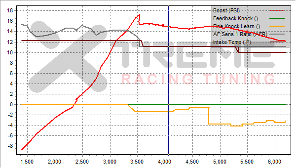

Cobb Stg2 OTS Data
Posted: Sat Oct 21, 2017 8:55 am
Cobb Stg2 OTS Gear Pull Critical Data.png (17.19 KiB) Viewed 20224 times
Cobb Stg2 OTS - 3rd Gear Dyno SAE.png (30.05 KiB) Viewed 20224 times

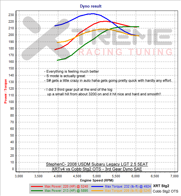

XRTv4 vs Cobb Stg2 OTS - 3rd Gear Dyno SAE
Posted: Sat Oct 28, 2017 5:20 am
XRTv4 vs Cobb Stg2 OTS - 3rd Gear Dyno SAE.png (54.56 KiB) Viewed 20205 times

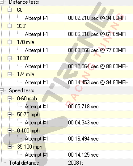

Re: StephenC- 2008 USDM Subaru Legacy LGT 2.5 5EAT
Posted: Tue Dec 05, 2017 10:16 pm
v7b Drag Pull.png (100.8 KiB) Viewed 20103 times

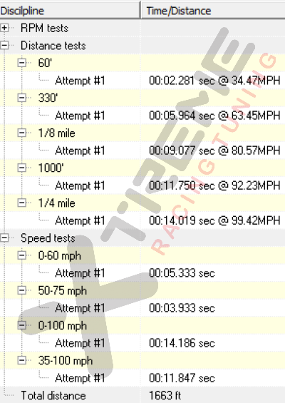

v10 Drag Results
Posted: Fri Mar 30, 2018 9:59 am
1/4 mile. Flat, wet roads, no wind I think.......iffy launch, but the car felt pretty quick.
v10 Drag Pull.png (82.2 KiB) Viewed 19742 times

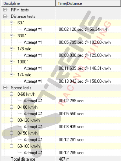

v10a Drag Results
Posted: Sun Apr 01, 2018 10:35 am
Finally in the 13's.
v10a Drag Pull.png (83.3 KiB) Viewed 19672 times
