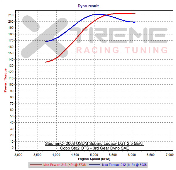

Cobb Stg2 OTS Data
Cobb Stg2 OTS Gear Pull Critical Data.png (17.19 KiB) Viewed 20237 times
Cobb Stg2 OTS - 3rd Gear Dyno SAE.png (30.05 KiB) Viewed 20237 times

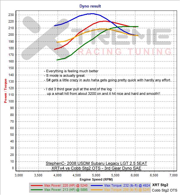

XRTv4 vs Cobb Stg2 OTS - 3rd Gear Dyno SAE
XRTv4 vs Cobb Stg2 OTS - 3rd Gear Dyno SAE.png (54.56 KiB) Viewed 20218 times
v4b Customer logs review
OK we are close this one was good!
Town driving--Throttle response is still nice and strong-nothing changed there and that is good. A little jumpy in S# at ~25% throttle around 3K in 2nd and 3rd BUT** it's very responsive to input and i don't have the most steady foot on bumpy roads:-) doesn't do it in S mode so yeah...my foot lol!
3rd gear pull-- Only 1 single instance (single cell) of ping (-1.5) right before peak boost. a few -1.5 cells as I lifted off throttle at 6000rpm. Feels Strong.
How it feels on the 3rd gear pull--pulls harder as the boost spools up--perfect!. It feels like it hits a shot of Nitrous about 4600RPM as it transitions from 8.5degrees to 10.5degrees of timing. It's subtle, not a surge, but I thought I'd point that out.
Roll on acceleration about 3000rpm---amazing in all gears. I don't really feel that transition in this circumstance.
2nd gear is just nuts. I never really tried it before at WOT. SO yeah, nice one!
Shifting--under load, nice and sharp and quick. I don't know if it's possible to tune this----> but it would be nice for the trans to respond faster to paddle inputs, especially at light load around town. No big deal though;-)

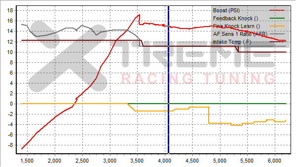

v7b Drag Pull.png (100.8 KiB) Viewed 20116 times

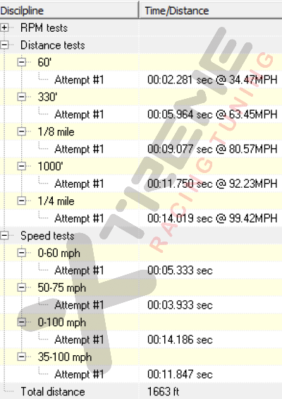

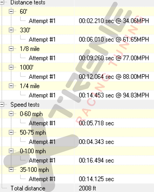

v10 Drag Results
1/4 mile. Flat, wet roads, no wind I think.......iffy launch, but the car felt pretty quick.
v10 Drag Pull.png (82.2 KiB) Viewed 19755 times

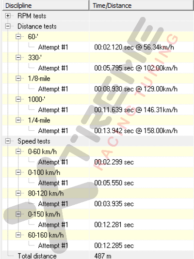

v10a Drag Results
Finally in the 13's.
v10a Drag Pull.png (83.3 KiB) Viewed 19685 times
