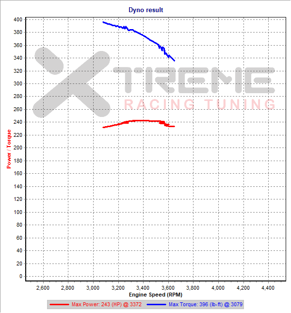

Posted: Fri Oct 06, 2017 10:02 pm
v4 Partial 4th Gear Dyno SAE @ 23.5psi.png (21.89 KiB) Viewed 12212 times
https://www.facebook.com/XtremeRacingTu ... =3&theater
Anyway, the tuning process with Ed makes me feel that we are the factory test driver fine tuning the car. It's not just doing 3rd gear pull, Ed will ask u to log under different driving condition as well and fine tune according to the logs and your driving experience revision by revision.

We are having flow issues over 230-240whp.
