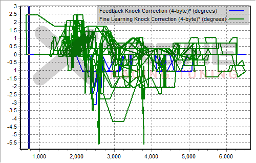

Stock Pinging.png (17.29 KiB) Viewed 9543 times

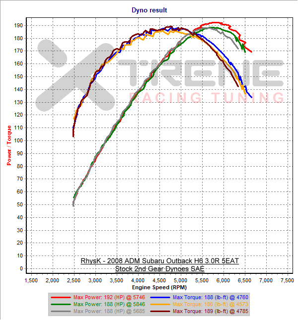

Stock 2nd GEar Dynoes SAE.png (35.69 KiB) Viewed 9513 times
