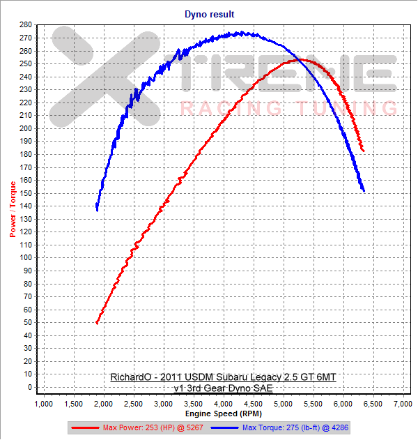

v1 3rd Gear Dyno SAE
Posted: Mon Jul 31, 2017 12:01 am
v1 3rd Gear Dyno SAE.png (31.11 KiB) Viewed 13910 times

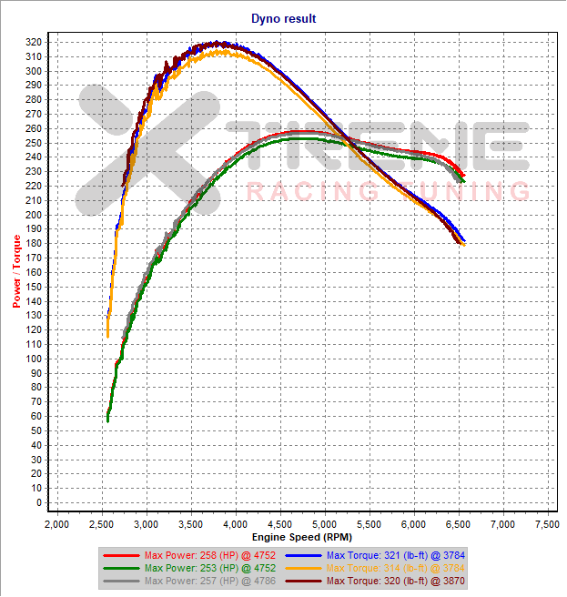

V2 Dyno
Posted: Mon Aug 07, 2017 3:07 pm
v2 vs Stock - 3rd Gear Dyno SAE.png (46.29 KiB) Viewed 13879 times

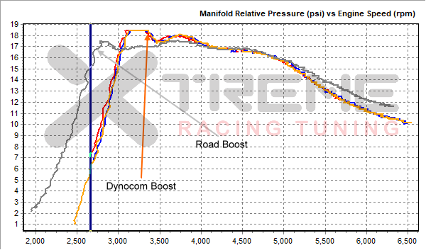

v3f Dyno Boost Comparison.png (24.63 KiB) Viewed 13821 times
v3f Dyno SAE @ 18psi IAT=49+C.png (29.39 KiB) Viewed 13821 times

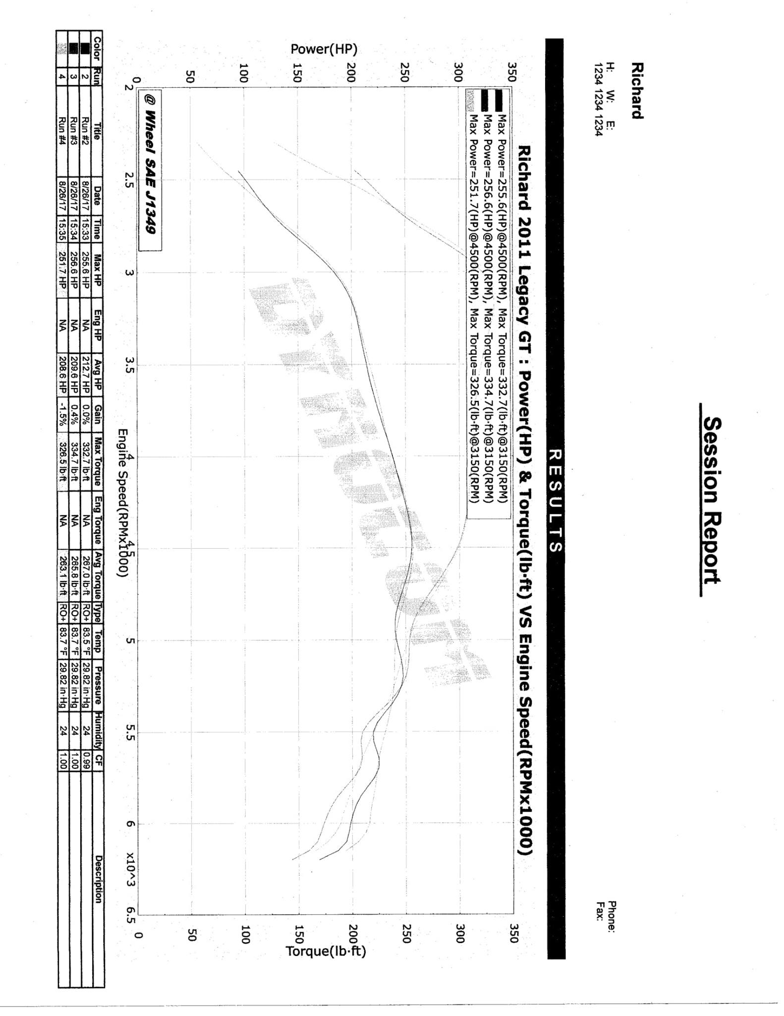

My experience with XRT has been amazing. At first, I had a stage 1 OTS cobb tune and loved it. That opened the car up to what it was capable of and once I realized that, I got hungry for more. I saw a post about XRT and started to get incredibly curious on all the gains someone received from them. Once I emailed XRT(Ed), he informed me BlackBerry Messenger(BBM) is how he chats with all his clients. He is based in the Barbados so we can call each other on BBM or Whatsapp to avoid oversea charges. After tons of research and seeing no other tuner is pushing out that type of gain with my mods, I sold my AP3, and was ready to start. Ed informed me to download Team Viewer so he could remote into my machine and download all the applications needed to setup the logging parameters and created the file structure for logs and roms. Even if you are not a newb to open source tuning, LET HIM SET IT UP. It will be easier for everyone and if there are any issues, he is perfectly capable of correcting them.
Once all the preliminary stuff was done, he sent me a version zero rom to show me that my car is capable of a lot with stock boost. My jaw dropped. Throttle response was insane, the torque was there, and you can clearly feel that the car enjoyed it much more than the Cobb OTS tune. As the process continued, you could feel the car run better and better as the days went on. He transformed my car so much, I would rather drive my car to work, Downtown Washington DC, than take the train. I feel like a little kid every time I hit boost now.
With XRT, they could get maps out same day or next day. Ed is very good with being responsive within a few hours and letting you know if you need to check something on your car or not. He is very particular about how he tunes a car and how it is running. Making sure your car is mechanically fine is key to having a smooth and successful tuning process. Overall, he is a skilled and very knowledgeable tuner. He changed my car from a slow non- responsive 2011 LGT into a responsive torque monster that I enjoy driving every single day. Boost comes on smooth, the car moves when I tap the gas and everything on the car feels great. It took about eight to nine revisions before the car got where it needed to be. He is done with my Subaru for now, but he will be doing my GF’s 100% STOCK CVT Crosstrek and I am sure I will see major improvements there! I attached a Dyno sheet along with Ed's Virtual dyno of the same dyno pulls.
