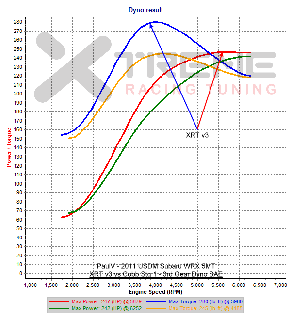

Remove Cobb AP and tuned with XRT
XRT Stg1
Stock 3rd Gear Dyno SAE
Cobbs Stock 3rd Gear boostvsAFR.png (29.89 KiB) Viewed 12269 times
XRT v0 vs Cobbs Stg1 - 3rd Gear Dyno SAE
XRT v0 vs Cobbs Stg1 - 3rd Gear Dyno SAE @ Stock boost.png (44.83 KiB) Viewed 12119 times
v3 3rd Gear Dyno SAE
v3 3rd Gear Dyno SAE.xml.png (38.19 KiB) Viewed 12118 times
Customer
I can definitely feel a difference in torque when compared to the off the shelf cobb tune but I need to upgrade the exhaust and downpipe to notice a big difference. Can't wait!
