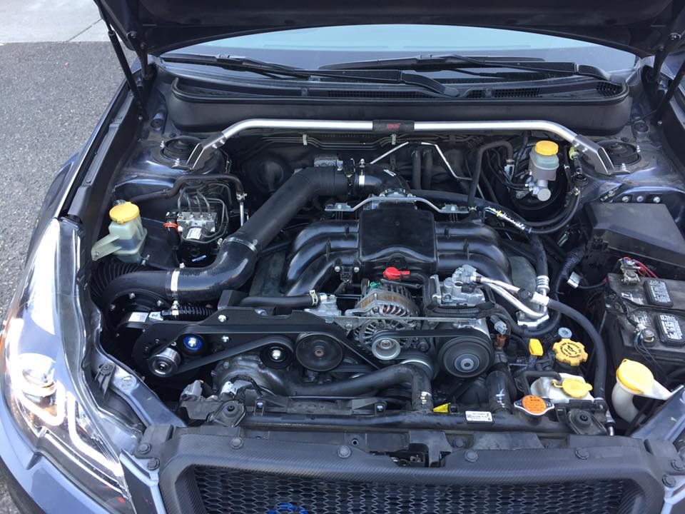

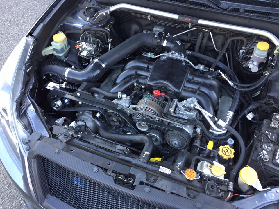

StaciT - 2014 USDM Subaru Legacy H6 3.6 5EAT - SC Tuning
Supercharged usign the Raptor Supercharger.
http://raptorsc.com.au/subaru/subaru-li ... arger-kit/
Owner: StaciT
Rom: DE5Q100C
Tyres: 225/40-19
Car Weight: 1608kg
Driver Weight: 113kg
Total Weight: 1721kg

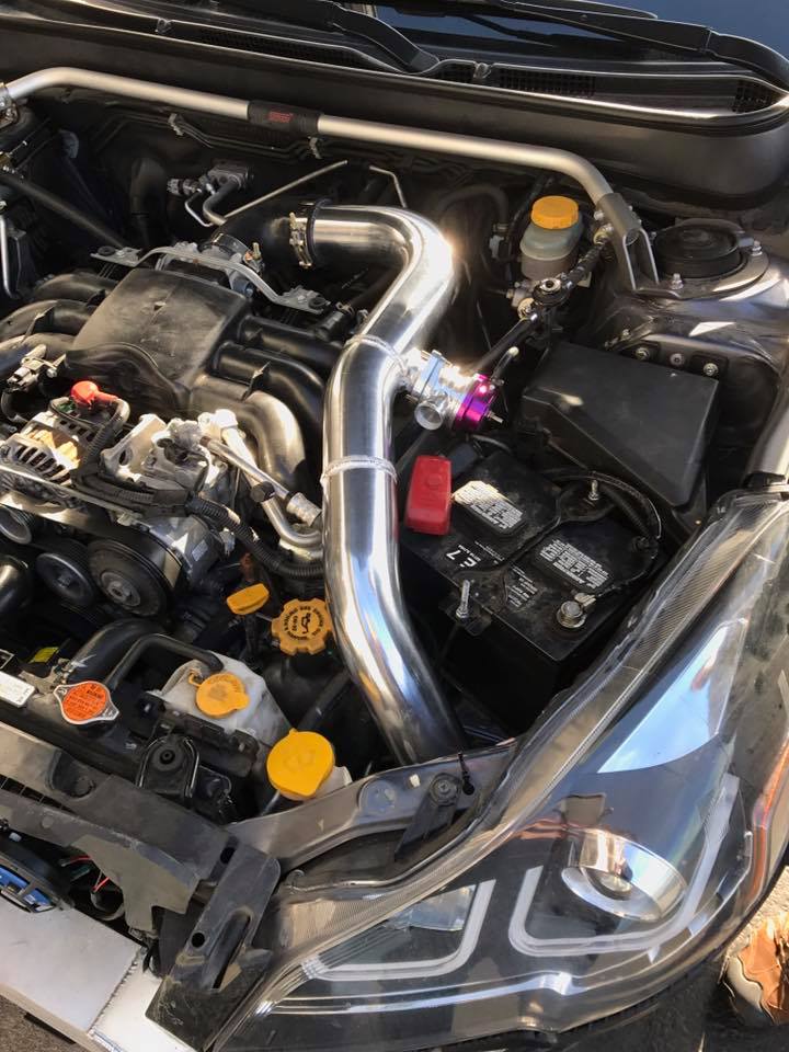

Raptor H6 3.6 ProStreet Supercharger
XRT-NA-SC Tuning
XRT-5EAT-Stg2 w/ XRT Torque Management Patch (XTMP)
STI 565cc Injectors
Most recent parts added:
Takeda intake
Subaru exhaust gaskets for H6
Vibrant gaskets and flanges
Kooks high flow racing cats (shop added O2 sensors)
Magnaflow 30 inch resonator
Custom cat-back with 3 inch pipe with a 15 inch resonator to a Nameless Performance axle-back exhaust with 4 inch mufflers
H&R sport lowering springs on OEM shocks
Goodrich braided brake lines (fixed that squishy feel under hard breaking)
EBC slotted rotors and Red stuff pads (LOVE THESE!!)
Legacy STI strut tower bar
TSW Nurburgring 19x8.5 on Bridgestone Potenza S-04 Pole Positions 225/40R19

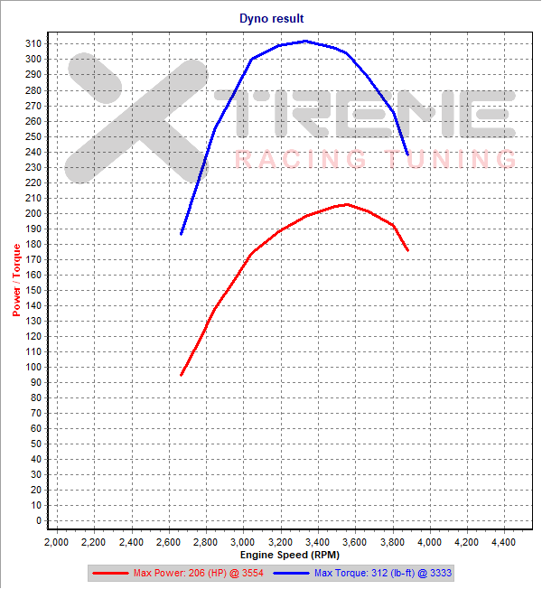

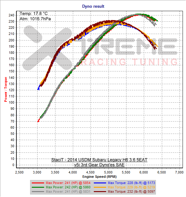

Based 3rd Gear Power will all mods before SC Installation
v5i 3rd Gear Dynoes SAE.png (38.78 KiB) Viewed 23206 times

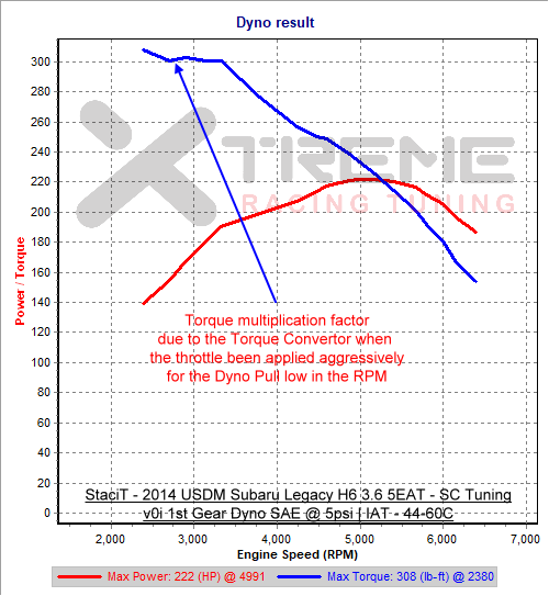

v0i Data
v0i 1st Gear Dyno SAE @ 5psi IAT-44-60C.png (38.17 KiB) Viewed 23054 times

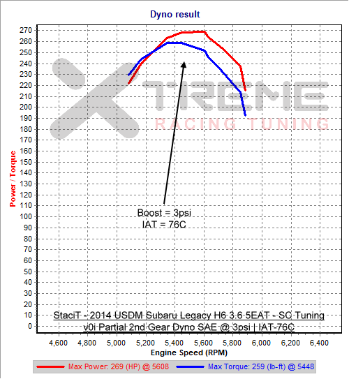

v0i 2nd Gear Dyno SAE @ 3psi IAT-76C.png (31.29 KiB) Viewed 23054 times

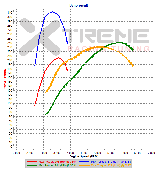

NA-v5h vs SCv0h Partial 2nd Gear Dyno SAE @ 0.1-2.9psi IAT-45C.png (27.25 KiB) Viewed 23048 times
v0h Partial 2nd Gear Dyno SAE @ 0.1-2.9psi IAT-45C.png (22.26 KiB) Viewed 23048 times

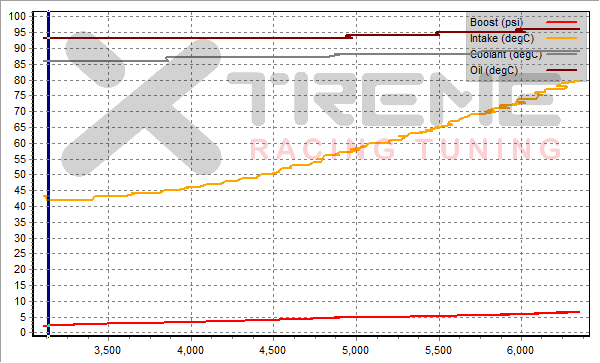

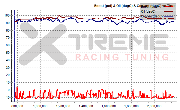

SCv5i Cooling issues.png (18.2 KiB) Viewed 23048 times
SCv2e Critical Data - High Intake Temperatures due to no IC
SCv2e Critical Data.png (15.36 KiB) Viewed 22935 times

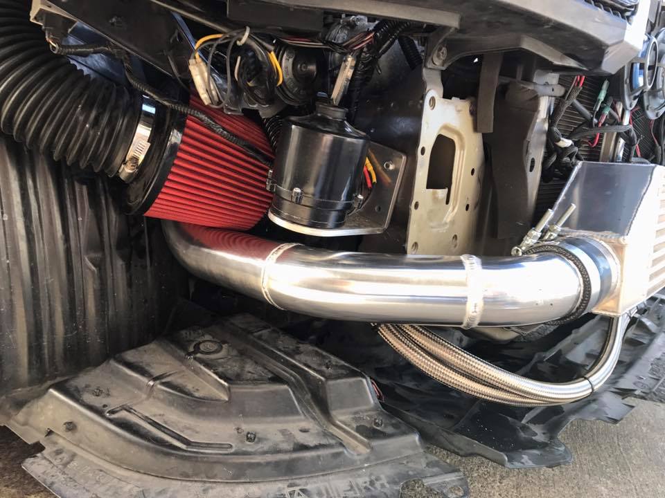

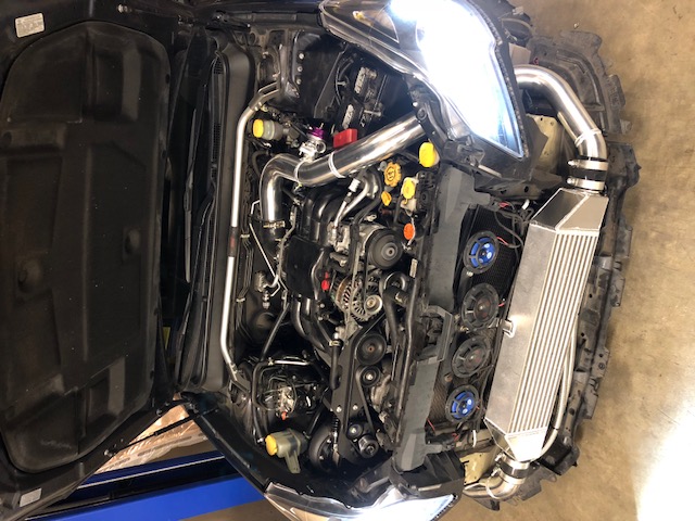

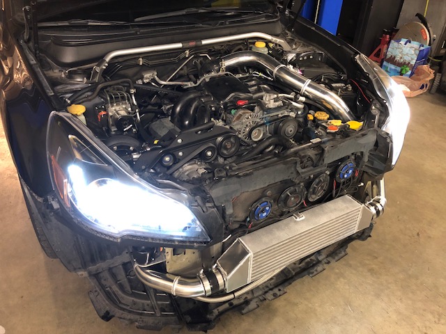

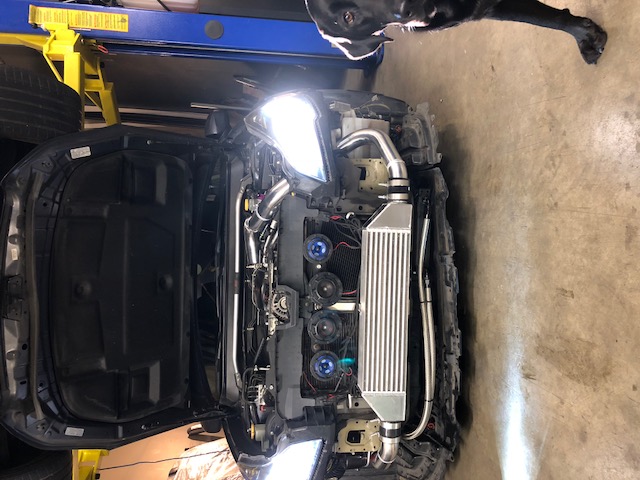

Newly FMIC installed
