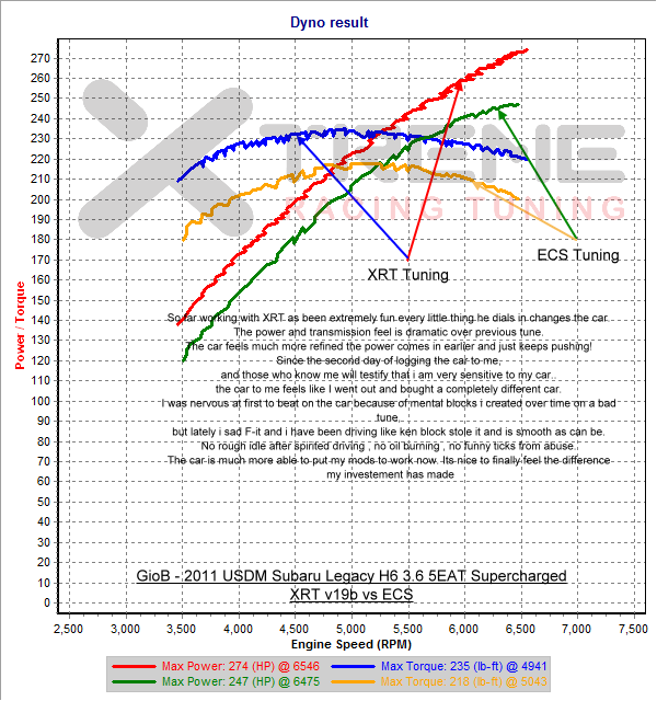

Review of rom:
  • Extremely rich - Cold start, cruising and etc were affected due to this excessive rich nature
  • Low Ignition Timing
  • Lack of Intake AVCS optimisation around 6000 and +
  • Lack of Exhaust ACVS optimisation in low rpm range
  • Non-Removal of rom limits to allow for safe tuning
  • Lack of good Engine Torque Request to allow for quicker and firmer shift. This can lead to clutch burning from the increase of torque the engine is making and slow clutch engagement. In many areas, it was even lower than the stock ROM
  • Stock OEM pump duty cycle was configured to operation at 100% all the time, even at idle

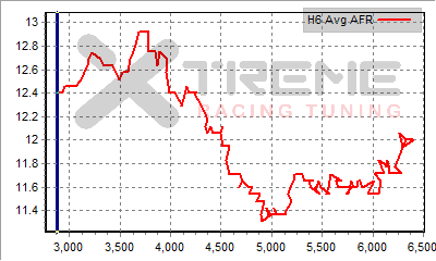

AFR #1 & AFR #2 shows some level of variance. Either an intake leak or header leak. AFR response times means there should be replaced.
v3 AFR.png (8.39 KiB) Viewed 26093 times
Request the customer to change plugs since the car been running extremely rich for a long period of time.

So far working with XRT as been extremely fun every little thing he dials in changes the car. The power and transmission feel is dramatic over previous tune. The car feels much more refined the power comes in earlier and just keeps pushing! Since the second day of logging the car to me, and those who know me will testify that i am very sensitive to my car.. the car to me feels like I went out and bought a completely different car. I was nervous at first to beat on the car because of mental blocks i created over time on a bad tune, but lately i sad F-it and i have been driving like ken block stole it and is smooth as can be. no rough idle after spirited driving , no oil burning , no funny ticks from abuse. The car is much more able to put my mods to work now. Its nice to finally feel the difference my investement has made and i am looking forward to one day becoming a tuner myself.

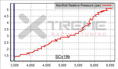

v19b 2nd Gear Dyno boost.png (8.94 KiB) Viewed 25907 times
v19b 2nd Gear Dyno SAE.png (100.94 KiB) Viewed 25907 times
