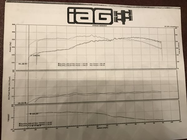

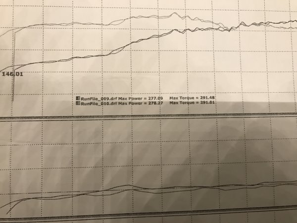

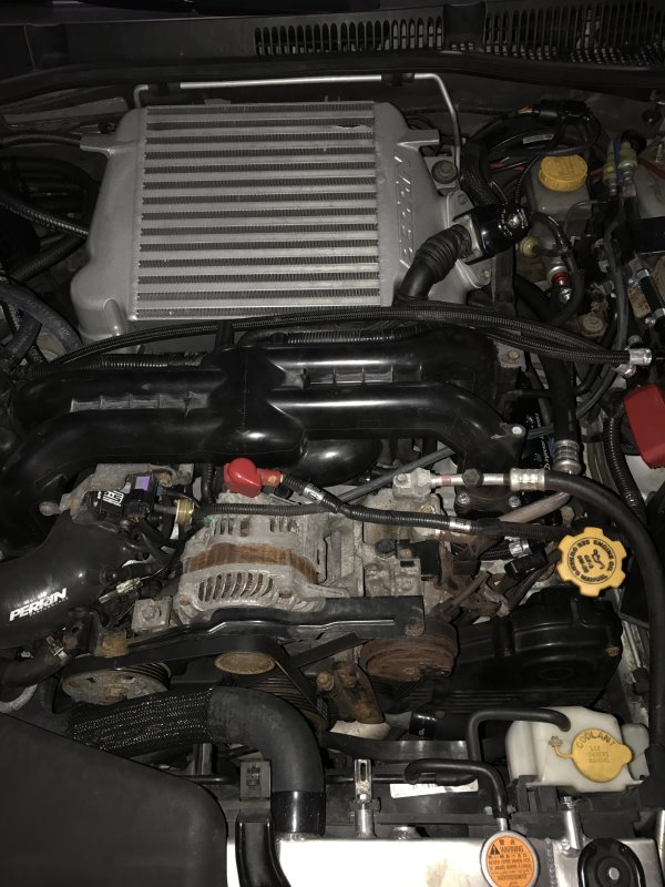

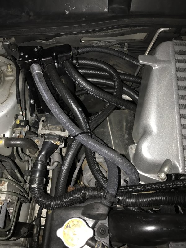

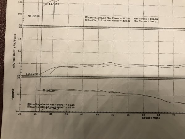

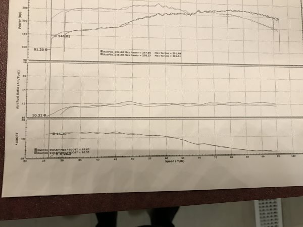

Engine picks + Previous Tuned Dynoes
IAG Tuned Quarter Mile.png (20.11 KiB) Viewed 13203 times
