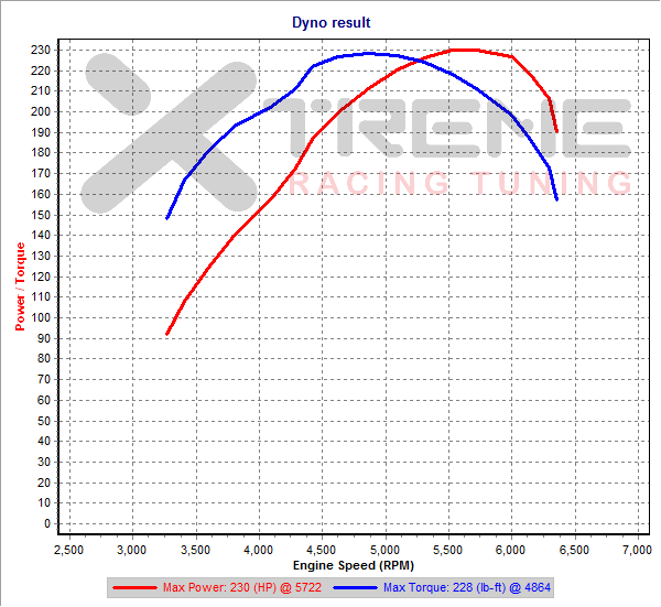

v5c 2nd Gear Dyno
Posted: Sun Feb 19, 2017 9:09 pm
Awaiting more graphs to finalised the power.
v5c 2nd Gear Dyno SAE #1.png (21.13 KiB) Viewed 16008 times

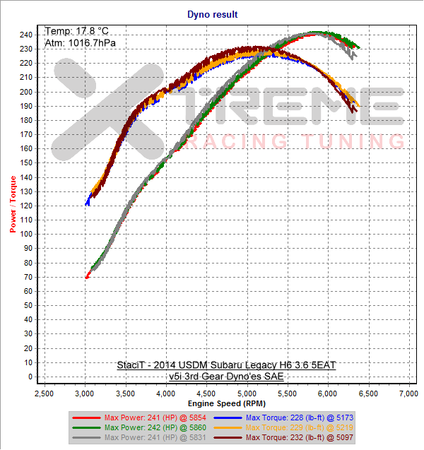

v5i 3rd Gear Dynoes SAE.png (38.78 KiB) Viewed 15502 times
