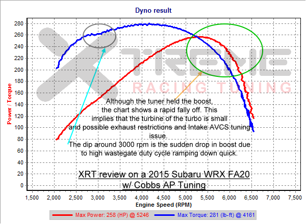

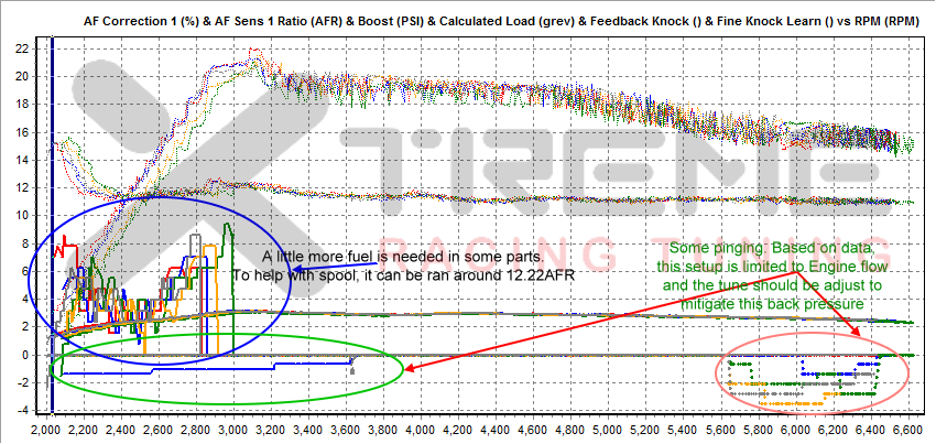

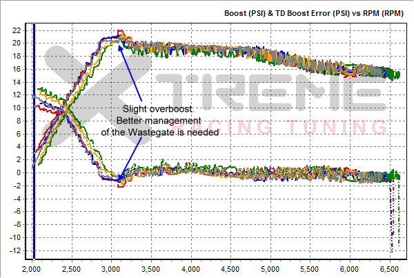

A very good customer of XRT shared this tuned Pro Tuned 2015 WRX using the Cobbs AP. I noticed all posting are using Cobbs kinda have the same graphing. My believe is that the Tuners are not spending enough time tuning the based map that comes with the Cobbs AP.

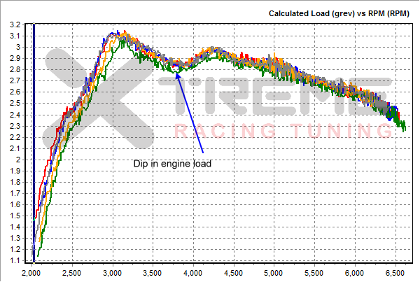

In the review of the WRX, I did not have some variables like the Intake AVCS to see if it was optimised, especially around the 3800rpm dip.
The FA20 engine is different to the BRZ engine, but demonstrates similar traits in its engine operations curve. After all, its in the FA20 family, but does not have port injection.
