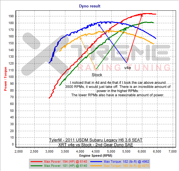

v4e Results
Posted: Sat Dec 31, 2016 10:18 am
I noticed that in 4d and 4e that if I took the car above around 3500 RPMs, it would just take off. There is an incredible amount of power in the higher RPMs. The lower RPMs also have a reasonable amount of power.
v4e 2nd Gear Dyno SAE vss #1.png (55.24 KiB) Viewed 12842 times
