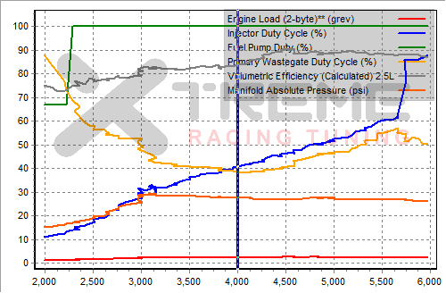

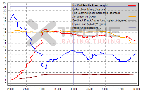

Stock Data #1.png (16.13 KiB) Viewed 9377 times
Stock Data #2.png (19.22 KiB) Viewed 9377 times

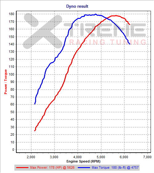

Stock 2nd Gear Dyno SAE.png (23.21 KiB) Viewed 9377 times

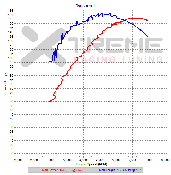

v1 Dyno - 2nd Gear
Posted: Sat Oct 01, 2016 10:39 pm
At the present, no boost tuning been done. Just working on fueling and ignition
v1 2nd gear Dyno SAE.png (17.2 KiB) Viewed 9361 times
