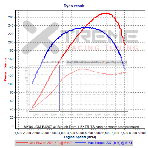

v2 @ wastegate pressure
Posted: Thu Mar 02, 2017 10:34 pm
Still under wastegate pressure of 15psi by 2psi and way under normal operating boost of 19-20psi.
GpN2v2 4th Gear Dyno SAE.png (46.84 KiB) Viewed 21304 times

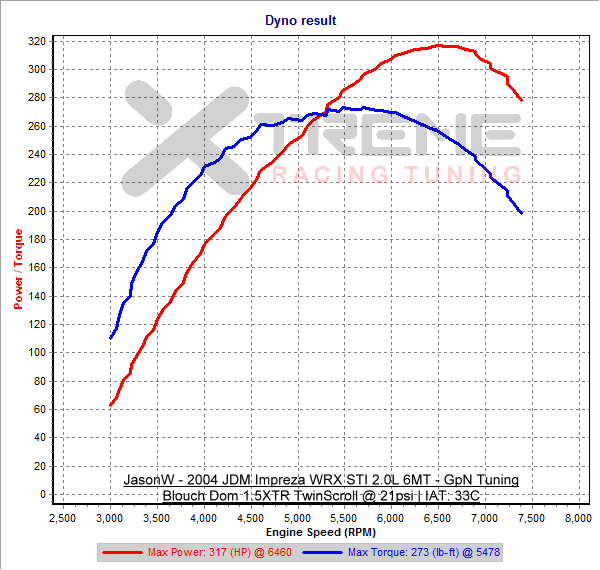

Blouch Dom 1.5XTR TwinScroll @ 21psi | IAT-33C
Posted: Sat Jul 15, 2017 11:18 am
BlouchDom15XTR-TS @ 21psi-IAT-33C.png (30.76 KiB) Viewed 20901 times

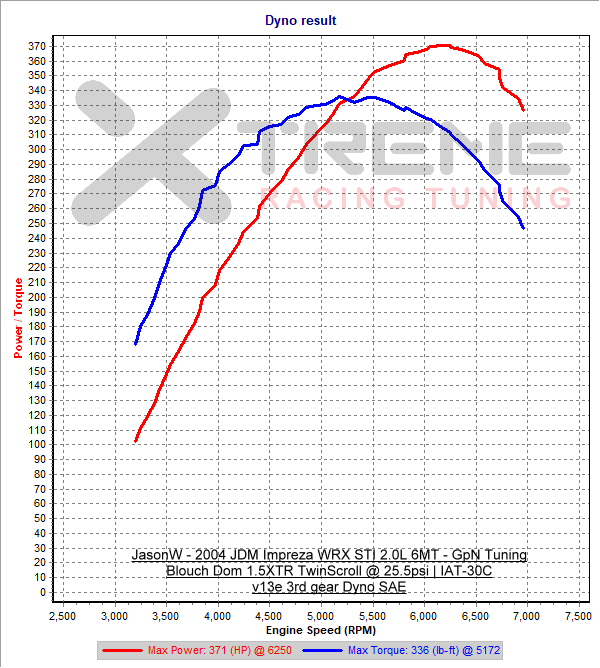

v13e 3rd Gear Dyno SAE @ 25.5psi | IAT=30C
Posted: Thu Sep 14, 2017 7:32 pm
v13e 3rd Gear Dyno SAE @ 25.5psi.png (38.95 KiB) Viewed 20716 times

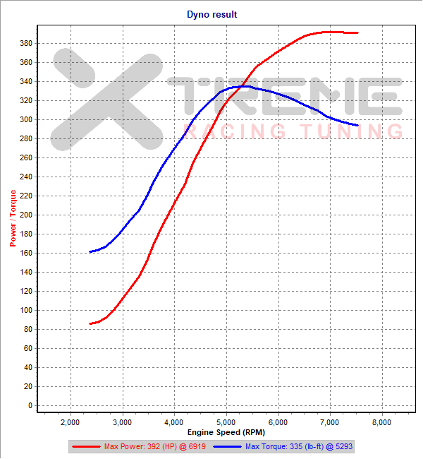

v16a 3rd Gear Dyno SAE
Posted: Tue Oct 24, 2017 9:29 pm
v16a 3rd Gear Dyno SAE.png (22.91 KiB) Viewed 20570 times
