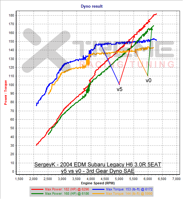

v5 vs v0 - 3rd Gear Dyno SAE.png (43.84 KiB) Viewed 11572 times

Here you go:
Ed was very helpful and responsive to all my questions, needs and quirks. I am not the regular client because of my suspicious nature and because of all my wishes to make all things by myself
Actually i was very ...hm, active and demanded in the process of tune development, so i think that he is very patient man :D
About the tune - the car's TCU seem to have some kind of Torque converter software bug, so the full potential of the tune is still waiting for resolution of this TCU problem, but i'm sure that resolution will unleash all the tune's positives.
With the last version the car is more responsive, have a good amount of low rpm range torque, gear changes are smooth all the way up to last gear, no matter what is the load, vehicle or engine speed.
Thank you, Edward, for letting me using you as a teacher in ECU tuning, for answering of all my stupid questions and at least, but not last - for the result, which is almost what i was expecting (damn you, TCU).
