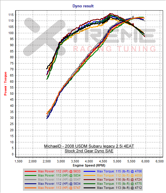

Posted: Sat Feb 06, 2016 8:39 pm
Stock 2nd Gear Dyno Stats.png (15.71 KiB) Viewed 36040 times
Stock 2nd Gear Dynoes SAE.png (37.7 KiB) Viewed 36040 times

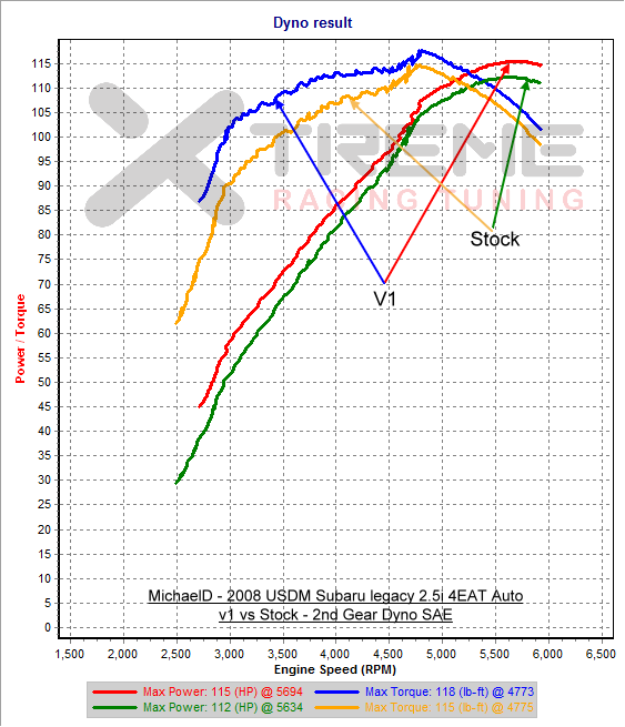

v1 feedback
Posted: Wed Feb 10, 2016 12:32 pm
v1 vs Stock - 2nd Gear Dyno SAE.png (40.98 KiB) Viewed 36017 times
http://legacygt.com/forums/showpost.php ... stcount=26
Loaded the V1 Tune (In Sport Mode)
Well Last night I loaded up the V1 tune and let me say it was NASTY :eek:. The car ran so well. from the first start the sound of the car was different, deeper like it was just mad for no reason. :spin::mad: I like it. :lol:
I drove through town to the highway and noticed it was even better to drive than the v0a tune. The car was shifting so smooth, and the drivability was still very nice and not harsh. This mean I can drive around town and still be happy.
I got to the highway and some a@@ hat decides to pull my card. So in sport mode I just pressed the gas and it rocketed off pulling hard :eek:. I though to my self, "damn XRT racing hooked it up".
So I get to my open road that's nice and flat and get the first pull in and the car is running fantastic. Pulling strong, tranny is shifting quick. I did few more pulls and headed back home. I did a 2nd and 3rd gear pull in manual mode and the car was just pulling past triple digits with no problem.
well I talked to Ed at XRT and he found some things that needed improved on and sent me the V2 tune :eek:. I am going to load this up soon and get to logging.
Stay tune for more XRT Racing tuning fun :spin:

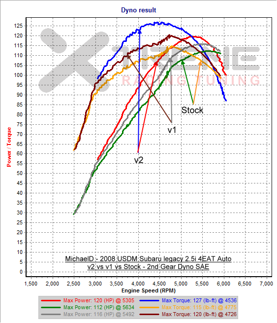

V2 & Tranny Stage 2 Initial review
Posted: Sun Feb 14, 2016 6:38 pm
http://legacygt.com/forums/showpost.php ... stcount=34
So after driving my 08 legacy2.5i with the XRT tinr and 4EAT , I really love the way the car drive's. I only now drive the car in Sport mode because it seems to run the best in this mode. you can control the way the transmission work with the pedal via the way the car is tuned. The car does really drive like a 5MT when ever you want it to. When taking off slowly the car goes through the gears like normal, and shifts very smooth with no issues.
Now I tested out the take off from a dig and the car sprints off like a gazelle running from a lion.:eek: While doing this the car stays in correct gear so you have the power you need. Hills are so much easier to take. It's like there is no effort when taking a step hill.
This is also great when you want to hit the back roads, curves, PDX events or a Road course.:lol: It allows you to stay in the gear when your driving hard. No one want the down shift the transmission offers when you do not need it.
Now I wanted to make sure the car was tuned , while keeping the daily driver ability. Ed did a Fantastic job of this. I so happy I found him and pulled the trigger on getting the motor tuned and tranny via the tune. If your thinking about this, just make the leap and get it done. You will not be disappointed. :)
2015-02-15
https://www.youtube.com/watch?v=9080yj3EuTw
https://www.youtube.com/watch?v=5ylrWiH-dnc
v2 vs v1 vs Stock - 2nd Gear Dyno SAE.png (47.46 KiB) Viewed 36003 times

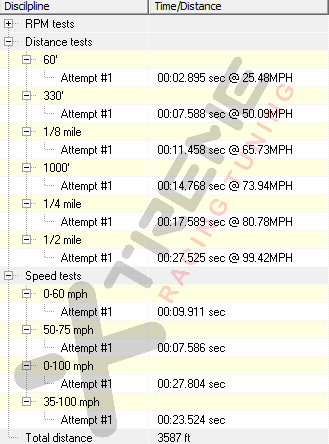

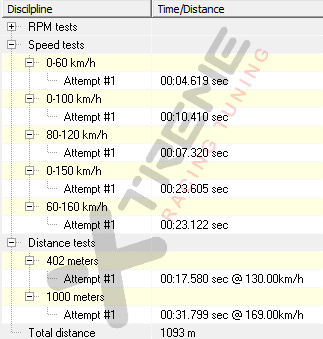

Posted: Sat Mar 05, 2016 8:25 pm
v5 Drags #1.png (22.27 KiB) Viewed 35880 times
v5 Drags #2.png (20.24 KiB) Viewed 35880 times
