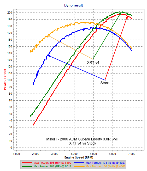

Posted: Sat Feb 06, 2016 9:10 pm
XRT v4 vs Stock - 3rd Gear Dyno SAE.png (33.93 KiB) Viewed 20377 times

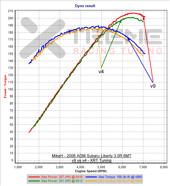

v9 3rd Gear Dyno SAE Comparison
Posted: Sat Mar 26, 2016 8:04 pm
Weather:- https://www.wunderground.com/history/ai ... reqdb.wmo=
v9 3rd Gear Dyno SAE Comparison.png (39.03 KiB) Viewed 20137 times

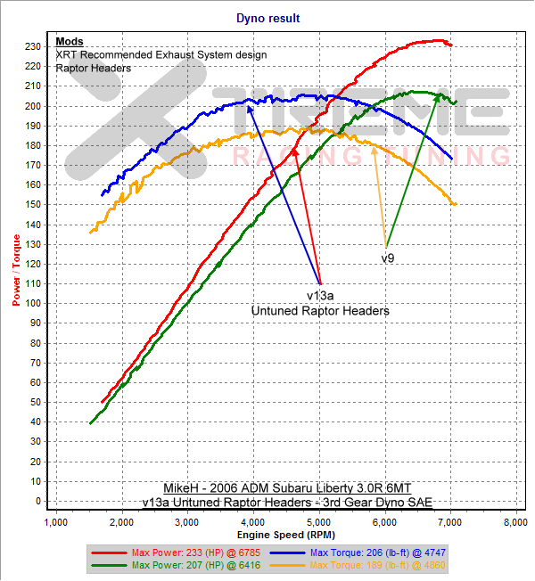

Posted: Sat Jul 22, 2017 9:32 pm
XRT recommended Exhaust System
v13 Raptor Headers vs Non Headers - 3rd Gear Dyno SAE.png (61.98 KiB) Viewed 16355 times
