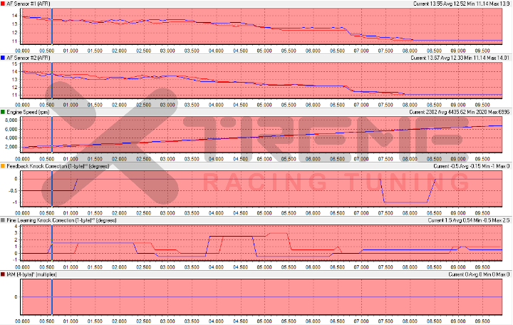

Stock 3rd Gear Dyno Stats #1.png (26.03 KiB) Viewed 8164 times

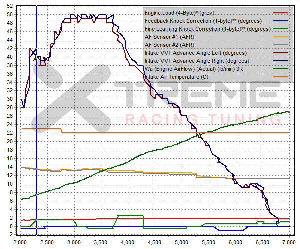

Stock 3rd Gear Dyno Stats #2.png (19.95 KiB) Viewed 8164 times
IAM is zero. Very little timing is added due to pinging.

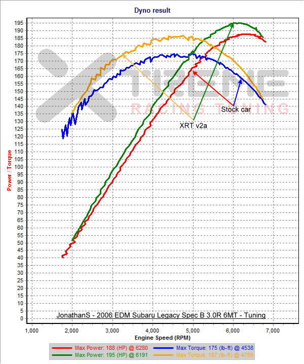

Stock 3rd Gear Dyno Stats #3.png (103.51 KiB) Viewed 8164 times
v2a vs Stock - 3rd Gear Dyno SAE
v2a vs Stock - 3rd Gear Dyno SAE.png (42.14 KiB) Viewed 8148 times
