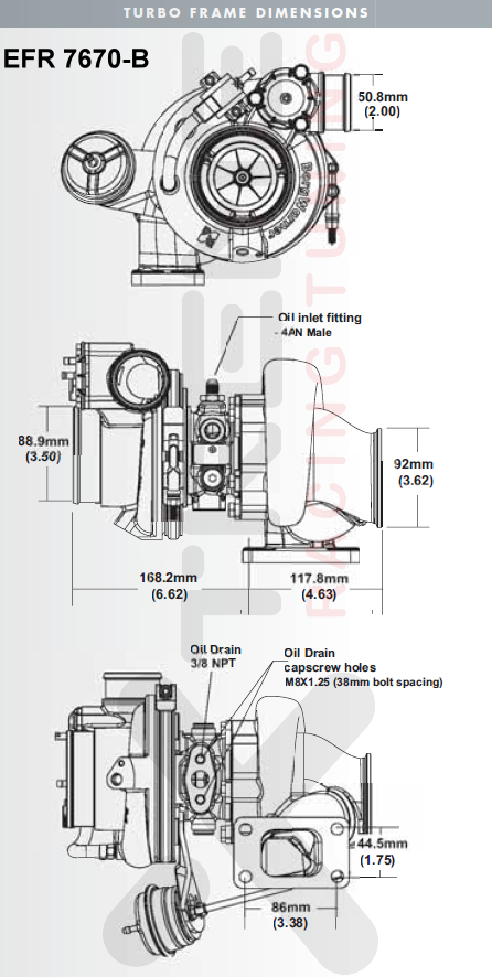

BW EFR7670-B Turbo - 0.83 A/R T3 Single Scroll (Internal WG)
BorgWarner: EFR 7670
CHRA: Ceramic Ball Bearing
Compressor Specifications
  • Compressor Type: Forged-Milled Wheel (FMW) Extended Tip
    Compressor Wheel OD (exducer): 76.00mm
    Compressor Wheel Inducer: 57.20mm
    Compressor Wheel Trim: 56.65mm
    Max Flow Rate: 64 lb/min (641chp)
    Built-in BOV: All EFR compressor housings incorporate an integrated BOV.
    Compressor Housing Connections: Inlet: 3.5" Hose Coupler
    Outlet: 2.0" Hose Coupler
Turbine Specifications
  • Turbine Type: Low Inertia Gamma-Ti Turbine Wheel
    Turbine Wheel OD (Inducer) : 70.00mm
    Turbine Wheel Extruder: 62.00mm
    Turbine Wheel Trim: 78.45mm
    Stainless Steel Sand cast Housing
    0.83 A/R T3 Single Scroll (Internal WG) - Part # 179351
    Turbine outlet: GT-Vband (aka small 3" vband) ~92mm OD for all EFR turbos
EFR 7670B Dimensions.png (268.37 KiB) Viewed 14081 times
