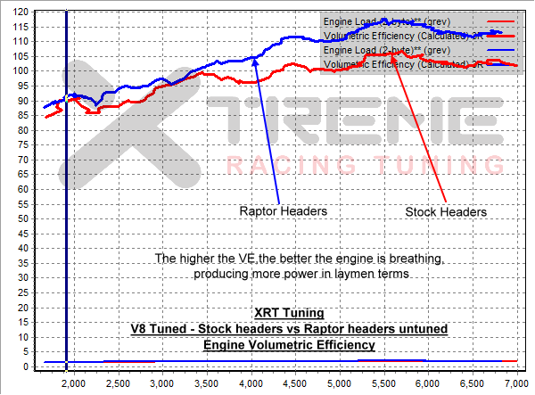

XRT Tuned - Stock Headers vs Raptor Headers.png (42.22 KiB) Viewed 10385 times

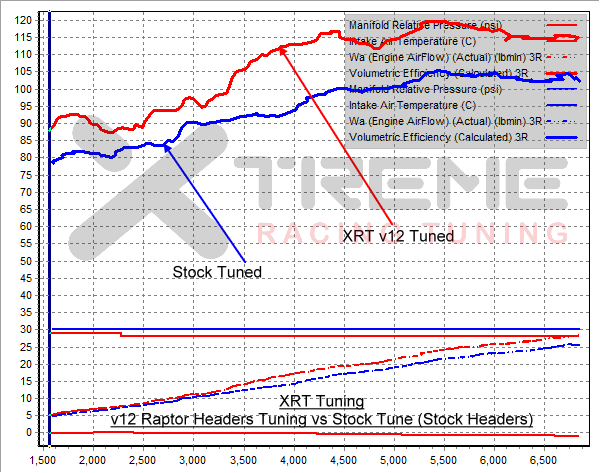

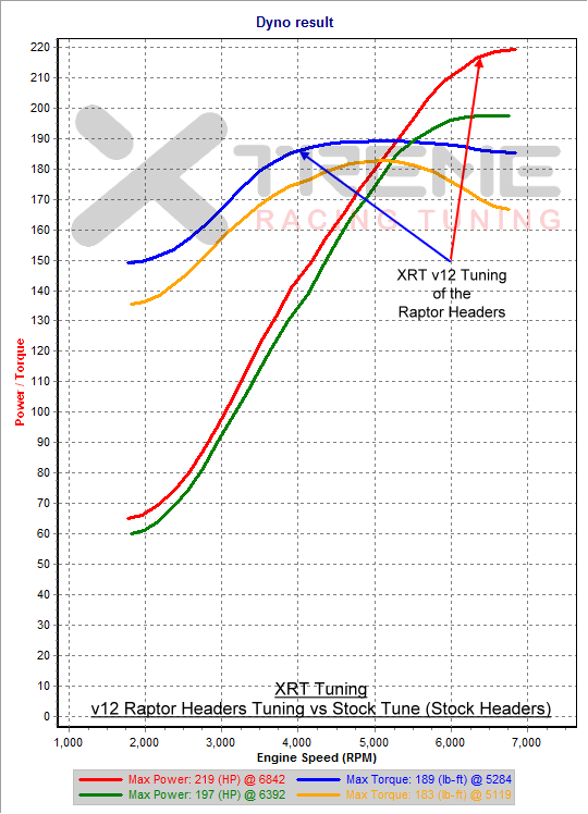

Below shows you the Raptor Header performance. The gains are good, but could have been better if the customer had better fuel to used. But on another note, the car begs for the Raptor SC or Turbo that would utilised the VE curve efficient
Looking at the VE graph, one can see that the car from 3500-6700rpm has a flat response and this is also shown by the Dyno graph. She just pulls all the way. In addition, 5500rpm most likely is the sweet spot when falling back in shifting or holding the revs at that point.
On another note, if you had to stick twin turbos on these headers, the Raptor headers would be prefect for that massive pull to the redline. Tim has a wonderful product and I am glad XRT had a part in helping in the development of them.
XRT v12 Raptor Headers Tuning vs Stock Tuned (Stock Headers) - 3rd Gear VE.png
XRT v12 Raptor Headers Tuning vs Stock Tuned (Stock Headers) - 3rd Gear VE.png (36.08 KiB) Viewed 10325 times
XRT v12 Raptor Headers Tuning vs Stock Tuned (Stock Headers) - 3rd Gear Dyno SAE.png
XRT v12 Raptor Headers Tuning vs Stock Tuned (Stock Headers) - 3rd Gear Dyno SAE.png (41.47 KiB) Viewed 10325 times
