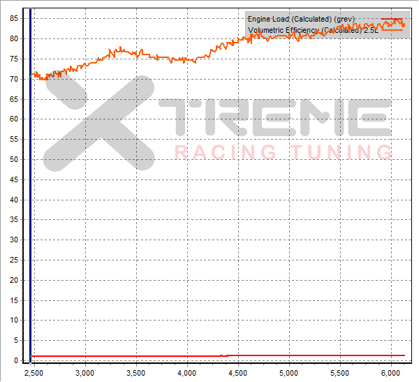

Stats #1.png (19.25 KiB) Viewed 8519 times

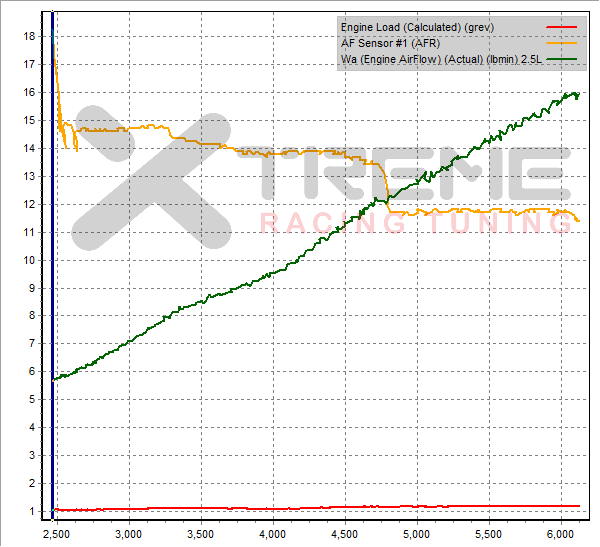

Stats #2.png (18 KiB) Viewed 8519 times

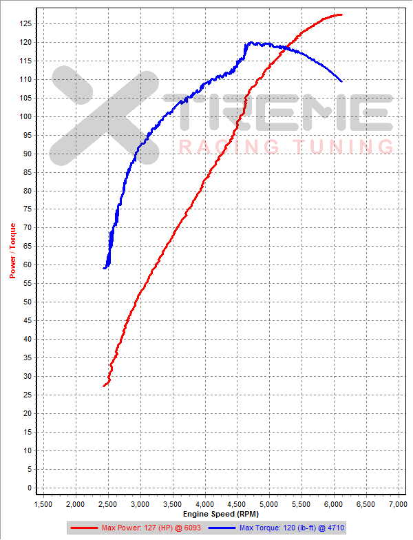

Stock 2nd Gear Dyno SAE sm=1.png (26.02 KiB) Viewed 8519 times
