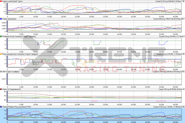

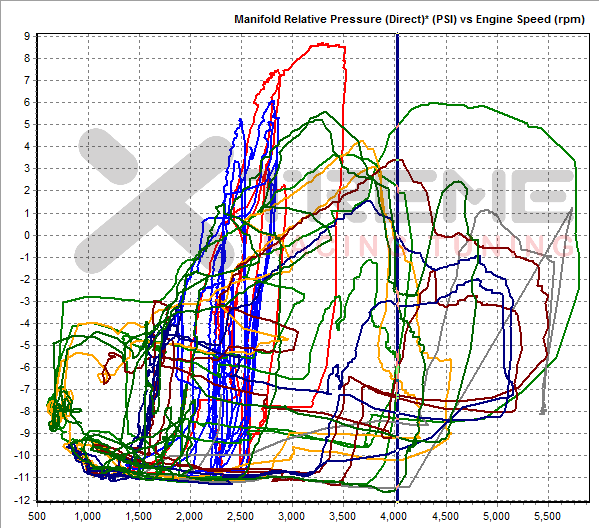

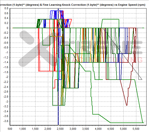

Dyno'es performed against rpm
Stock Data
Most of the pinging shown below is due to being in high gear. Example 4 and 5.
Stock Boost.png (41.95 KiB) Viewed 18317 times
Stock FKC_FLKC.png (27.96 KiB) Viewed 18317 times
Stock Critical Data.png (108.6 KiB) Viewed 18317 times
