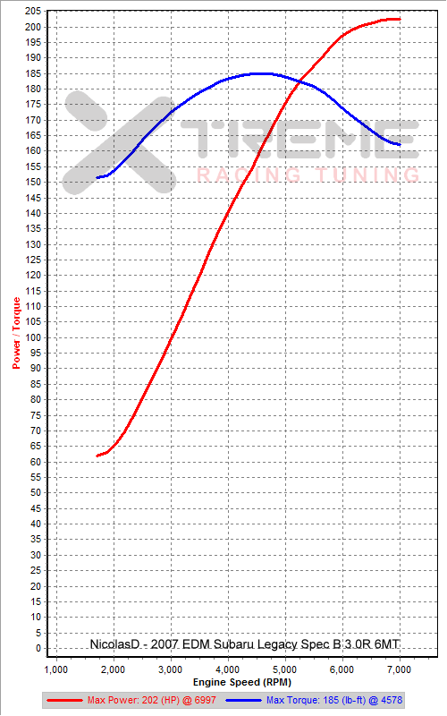

Stock 3rd Gear Dyno SAE sm=2 tm=150.png (30.06 KiB) Viewed 7778 times

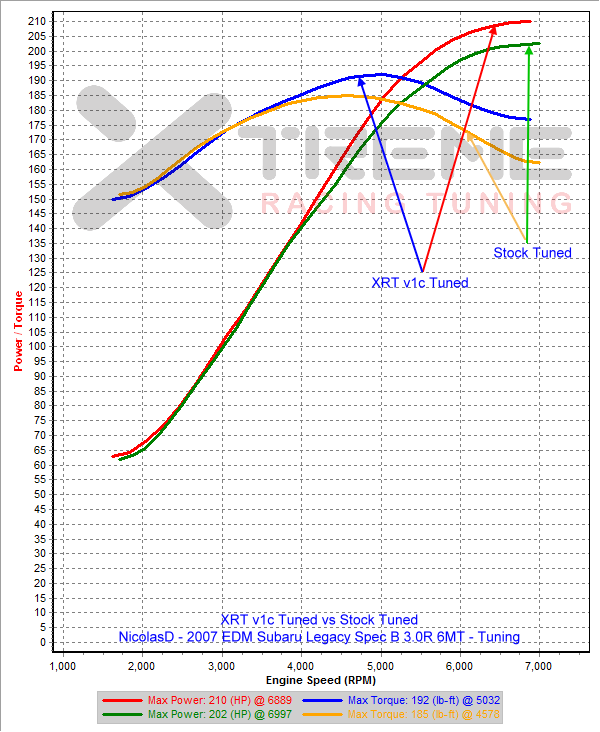

v1c Stats
Posted: Wed Apr 16, 2014 7:13 am
Subject: Re: v1c
Date: Wed, 16 Apr 2014 10:32:54 +0100 (BST)
From: NicolasD
To: Xtreme Racing Tuning
In I mode the car seems to have a slightly improved fuel efficiency. Comparison was done on a typical trip I often do (250 km), same conditions, avg 8.2l/100 km (tuned) vs 8.6l/100 km (stock, I have done this trip 10 times, it was always 8.6l / 100 km).
Next week, I will do an other trip where I have some references for the fuel consumption. Let's see.
So far the improvement over stock is amazing in term of driving pleasure, the car is much more reactive, I and S mode are now useable, great work Edward!
Cheers,
Nicolas
