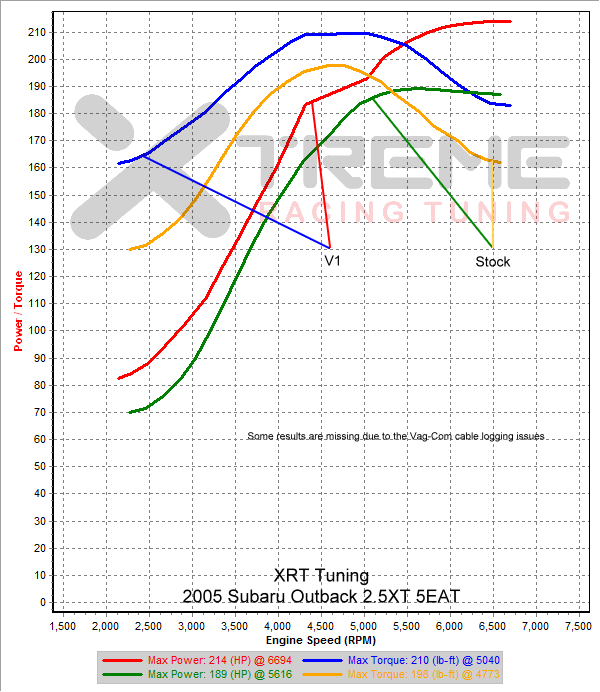

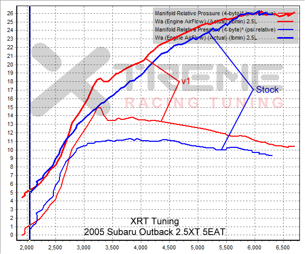

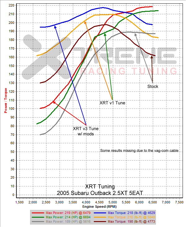

Update. We found some major leaks that plaques the USDM OBXT. TMIC is leaking and turbo issues. For right now we are resolving boost leak issues.
v4
Perrin TMIC
OBX equal length headers
Invidia divorced wastegate catted downpipe
WRX catless uppipe
K&N reusable/cleanable panel air filter
Heat wrap on uppipe, headers, and downpipe
Stock catback

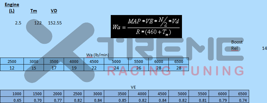

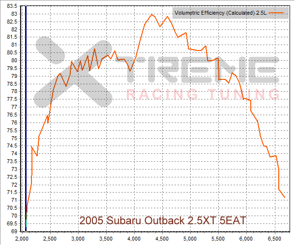

Ok. Here are my thoughts after working with "InTheBay" log reviews and general overview of the performance of the XT in a detail manner. That is looking at the boost response, Engine VE, Fuel, Ignition, etc and thinking of a possible turbo upgrade for the XT using either Blouch or BNR
Based on the internet feedback on the XT, I can safely assume "InTheBay" OBXT is no different to any other XT out there. Per usual, there is a lack of visual data on this and thanks to when I first started out Tuning, sites like Edge Tuning did just that.
If you look at the spec on the XT (Xtreme Racing Tuning ? View topic - ColinW - 2005 Subaru Legacy Outback XT 2.5 5EAT Tuning), I personally find it interesting the engine compression is low, but this could be due to "pissed" poor gas it may see around the world. Who knows. Compression is on par with STI's etc.
The turbo specs as noted on the internet and as show here (Xtreme Racing Tuning ? View topic - ColinW - 2005 Subaru Legacy Outback XT 2.5 5EAT Tuning), one can say it could be equivalent to the Garret GT2056:
Turbo PR.png (2.36 KiB) Viewed 26939 times
That being said from tuning, I hit a hard limit of 28+ lb/min engine flow. I could reach 30, but it doesn't make sense since the stock engine flows 26 and going to 28, I am see some pinging. So that tells me although there are mods like a bigger Perrin TMIC, new headers and full turbo-back exhaust system, there is a limit.

New mods
DW 850CC injectors
DW fuel pump
TGV Delete
BNR 18G turbo
Phenolic TGV spacers
