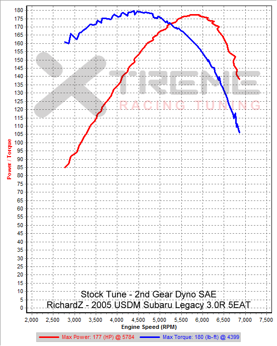

Stock Performance Data.png (21.31 KiB) Viewed 11196 times
Stock 2nd Gear Dyno SAE.png (37.48 KiB) Viewed 11196 times

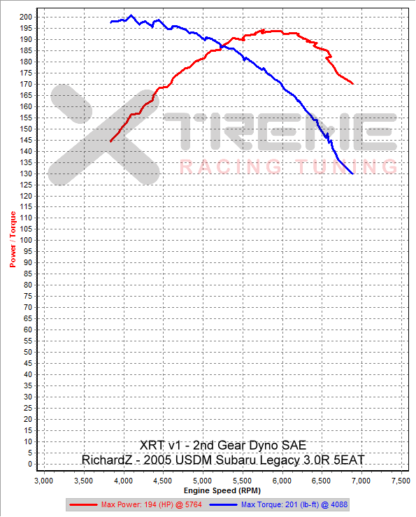

v1 2nd Gear Dyno SAE.png (35.24 KiB) Viewed 11226 times

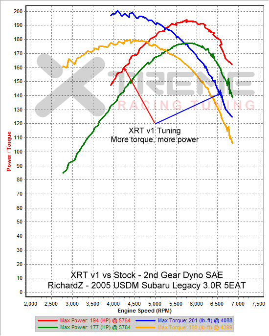

XRT v1 vs Stock Tuned - 2nd Gear Dyno SAE.png (45.14 KiB) Viewed 11196 times

Update: took my car to my local mechanic and had the spark plugs changed, vacuum leak test, o2 sensor and pcv valve checked out. Plugs don’t look like they’ve been changed, everything checked out good.
I had to load stock rom back on the car for a few days so I could do a stock 2nd gear pull for the log and also so my mechanic wont freak out when he hits the gas and realizes this is not a stock car. I’m still getting used to the changes to the drive by wire, my mpg has gone down but that’s due to me flooring the pedal in 1st gear just to feel the power I never had in this car before. People must think I’m trying to race them off the light when my car launches forward when just touching the gas, lol. So far Ed has done an amazing job!!! I’m very happy with the way the car is performing. Just waiting for raptor to get their new set of headers in stock so I can get them and have Ed retune them. The car feels better than ever! The power is great over hills, doesn’t have to shift down to get power, the gear changes are smooth and the sound of the engine now is unreal. I just need to do one more log and gear pull for final results. I can’t believe how fast and fun tuning really is when you have a great tuner that really knows what he’s doing and when he does it he does it right! I can now see why XRT is known as “vicious tuned, driven hard” stay tuned for more updates on my car.
