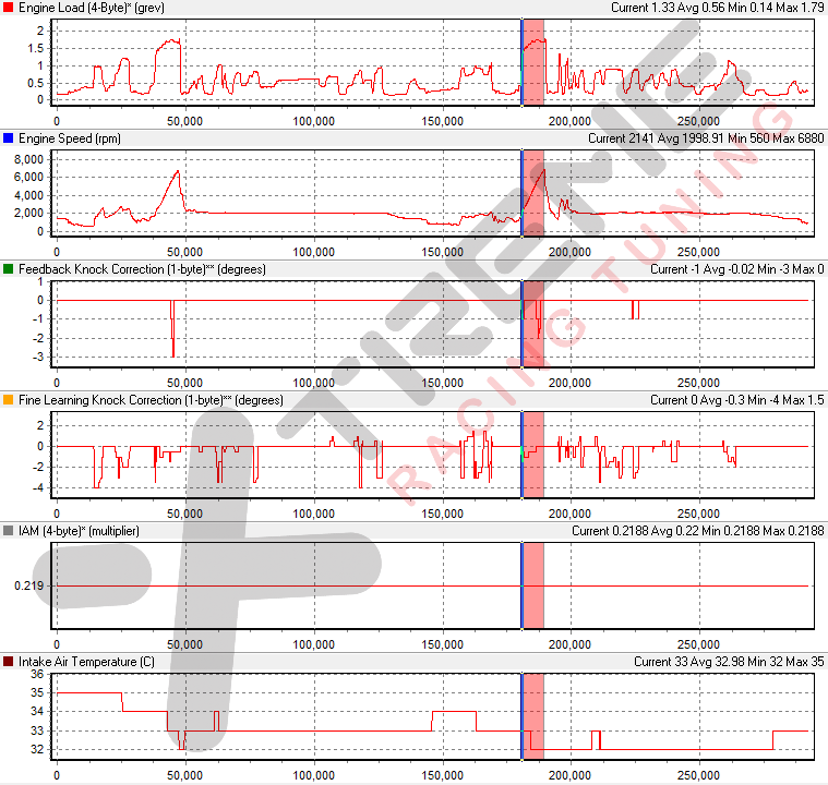

Posted: Fri Jan 31, 2014 10:46 pm
Stock Data.png (72.91 KiB) Viewed 6323 times

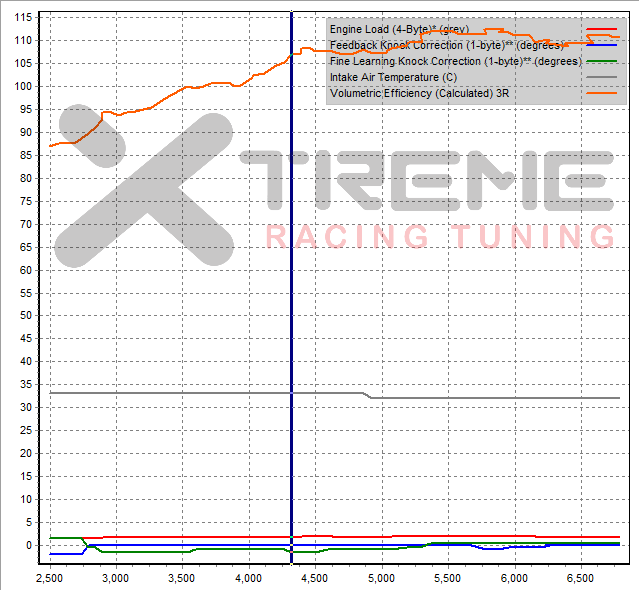

Engine VE.png (24.4 KiB) Viewed 6323 times

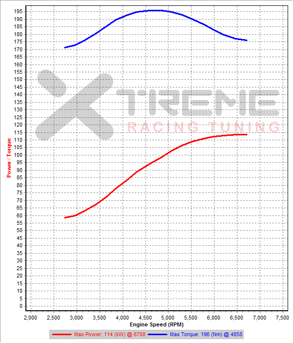

Stock 2nd Gear Dyno SAE sm=2 tm=200.png (24 KiB) Viewed 6147 times

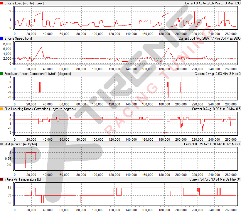

Stock Performance Data #1.png (67.98 KiB) Viewed 6302 times

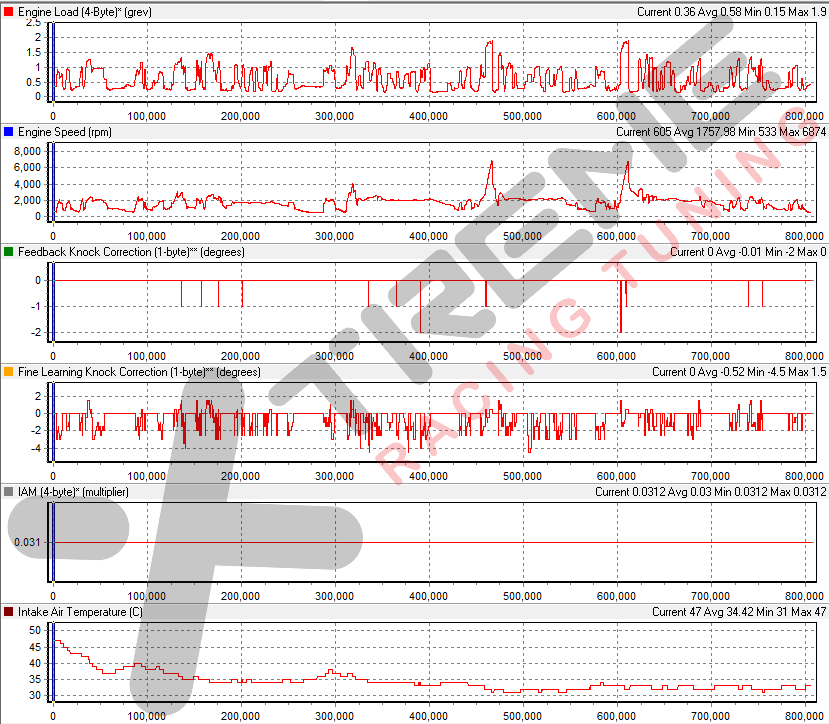

WIth Nulon PSO
Stock Performance Data with Nulon_PSO.png (72.02 KiB) Viewed 6302 times

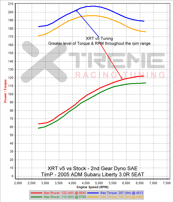

v5 vs Stock - 2nd Gear Dyno
Posted: Thu Mar 06, 2014 1:14 am
v5 vs Stock - 2nd Gear Dyno SAE sm=2 tm=200.xml.png (44.48 KiB) Viewed 6146 times
