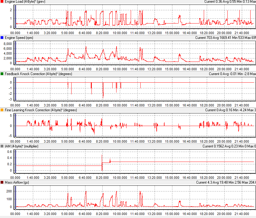

Stock Performance.png (30.17 KiB) Viewed 10971 times

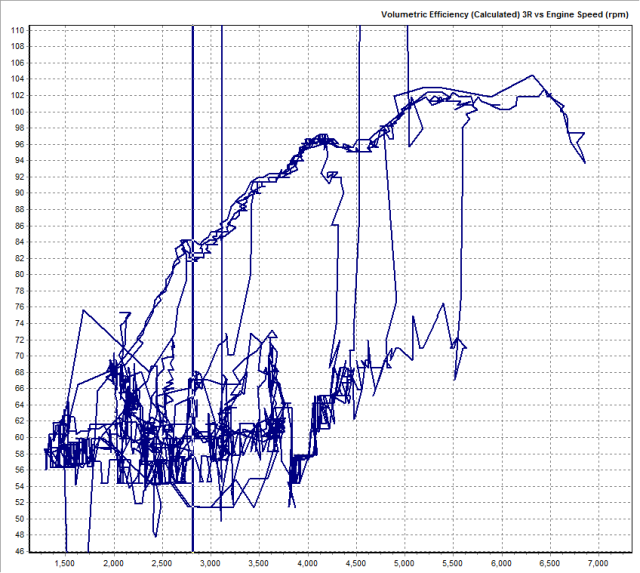

Stock VE Performance.png (116.35 KiB) Viewed 10971 times

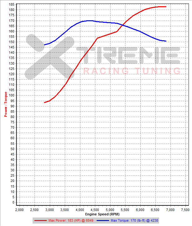

Stock 2nd Gear Dyno SAE.png (31.43 KiB) Viewed 10964 times

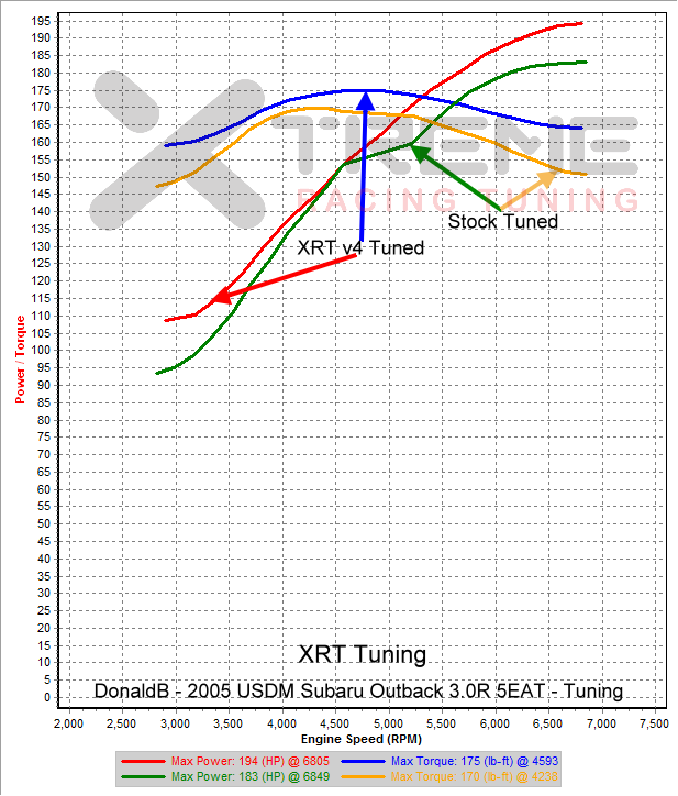

v4 Dyno
Posted: Tue Dec 03, 2013 10:57 pm
XRT v4 vs Stock.png (45.05 KiB) Viewed 10953 times

So back to the engine log. Ed tells me my 3.0R is running between 190-200HP and I'm no more than 175ft-lbs at the wheels. I'm using ethanol-free 91 AKI Esso gasoline. I went over some of the log yesterday afternoon and I half looked at the IAM and thought that at .4 it was a little low. Anyway, here's the link to the engine graphs:

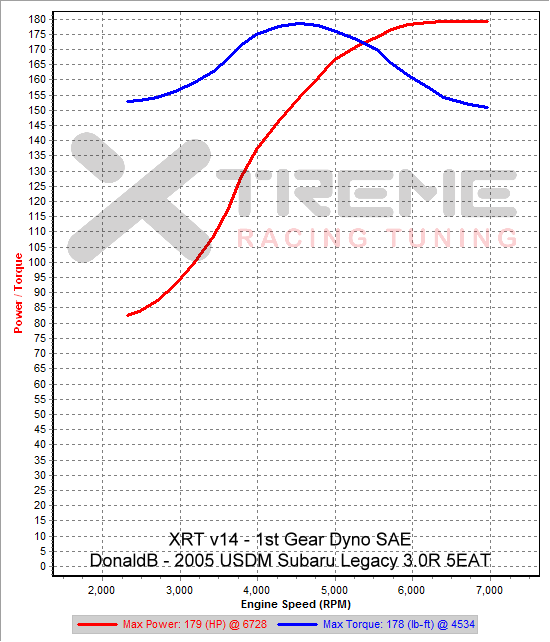

v14 Stats
Posted: Sun Feb 09, 2014 5:31 pm
Cats gutted due to failure of them
v14 1st Gear Dyno SAE #1 sm=2 tm=150.png (31.27 KiB) Viewed 10868 times

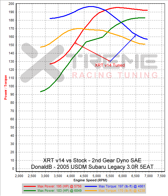

v14 vs Stock - 2nd Gear Dyno SAE #1 sm=2 tm=150.png (37.08 KiB) Viewed 10868 times

Before = 183WHP @ 6849RPM/170ft-lbs @ 4238RPM
After Ed = 195WHP @ 5756RPM/197ft-lbs @ 4861RPM, +7% HP, +16% torque, fully stock
