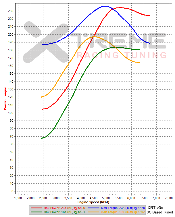

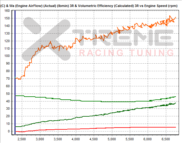

Max engine flow is around 28-29lb/min. This most likely is due to the exhaust and or intake system being very restrictive.

XRT_v0a 2nd Gear Pull IAT_vs_VE_vs_Wa_vs_boost
XRT_v0a 2nd Gear Pull IAT_vs_VE_vs_Wa_vs_boost.png (19.17 KiB) Viewed 10913 times

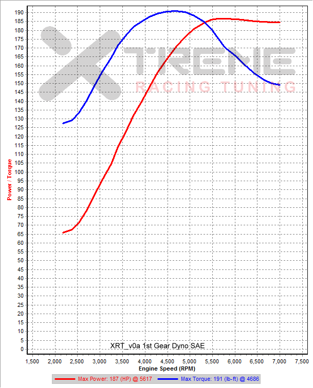

XRT_v0a 1st Gear Dyno SAE sm=2 tm=150 whp smaller tyres
XRT_v0a 1st Gear Dyno SAE sm=2 tm=150 whp smaller tyres.png (29.63 KiB) Viewed 10913 times
XRT_v0a vs SC-Based Tuned - 2nd Gear Dyno SAE sm=2 tm=150 whp smaller tyres
XRT_v0a vs SC-Based Tuned - 2nd Gear Dyno SAE sm=2 tm=150 whp smaller tyres.png (31.15 KiB) Viewed 10913 times
