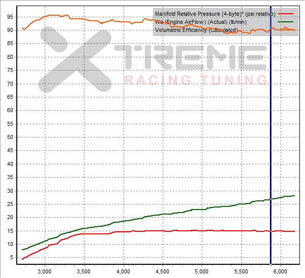

Stock 3rd Gear Dyno
Manifold Relative Pressure (4-byte)* (psi relative) & Wa (Engine AirFlow) (Actual) (lb/min) & Volumetric Efficiency (Calculated) vs Engine Speed (rpm)
Stock 3rd Gear Dyno Stats.png (19.25 KiB) Viewed 14472 times

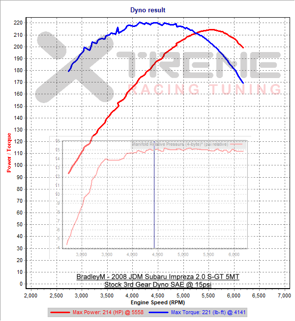

Stock 3rd Gear Dyno @ 15psi.png (53.4 KiB) Viewed 10627 times

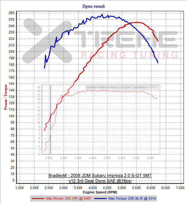

v12 Dyno Stats
XRT v12 3rd Gear Dyno SAE @ 18psi.png (58.41 KiB) Viewed 10625 times

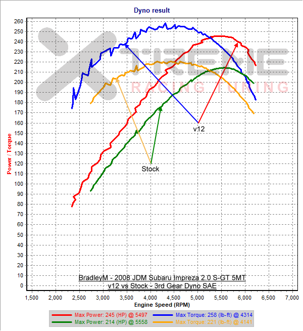

v12 vs Stock - 3rd Gear Dyno SAE
XRT v12 vs Stock Tuned - 3rd Gear Dyno SAE.png (43.51 KiB) Viewed 10624 times
