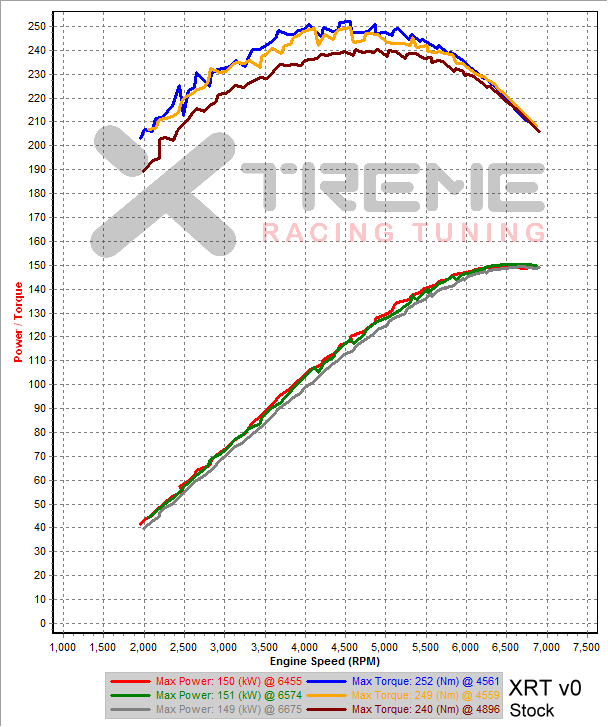

v0 Stats
Posted: Thu May 23, 2013 6:59 am
XRT v0 vs Stock - 3rd Gear Dyno SAE
XRT v0 vs Stock - 3rd Gear Dyno SAE.png (31.34 KiB) Viewed 20361 times

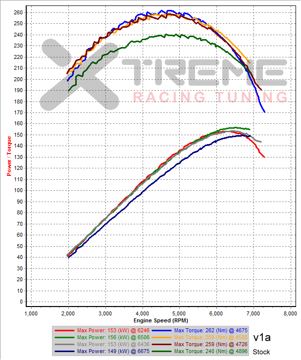

V1a Stats
Posted: Fri May 24, 2013 8:55 am
v1a 3rd Gear Dynoes SAE.png (32.59 KiB) Viewed 20356 times

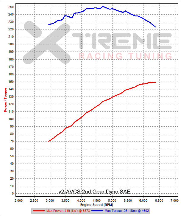

Re: DanielB - 2007 ADM Subaru Legacy 3R 6MT - Tuning
Posted: Mon Jun 03, 2013 7:28 am
v2-avcs 2nd Gear Dyno SAE.png (29.17 KiB) Viewed 20320 times
From: DanielB
Sent: Monday, June 03, 2013 7:06 AM
To: Edward
Subject: RE: v2-avcs
the car so has been awesome, today when I was driving spirited for the log it was a huge difference over stock, even compared to the previous rom, every rom has been an improvement that is easy to feel, even my misses said the car is much smoother and a lot more power, it will still take some time to get used to the response on the throttle as thee was so much lag before so I find myself quite often overrevving whilst taking off
your service has been great, sometime I think that I should be doing more or getting logs quicker, but you haven't seemed too fussed on it so the experience has been pleasant
thanks for your time and dedication Edward

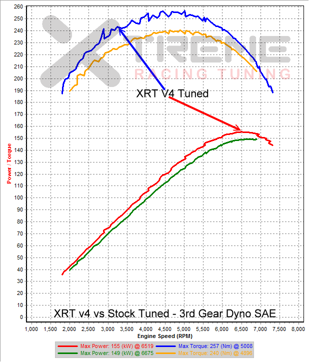

v4 Stats
Posted: Thu Jun 20, 2013 12:51 pm
v4 vs Stock - 3rd Gear Dyno SAE.png (39.77 KiB) Viewed 20242 times

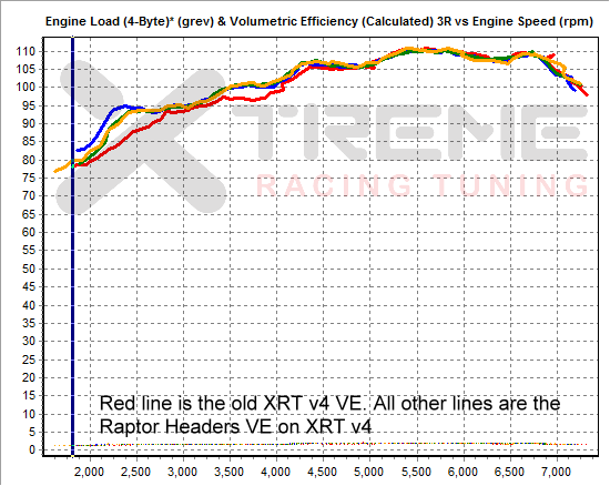

XRT v4 - Raptor Headers vs Stock Headers - 3rd Gear Dyno SAE
Posted: Tue Jul 02, 2013 9:05 am
XRT v4 - Raptor Headers vs Stock Headers - VE.png (26.46 KiB) Viewed 20184 times

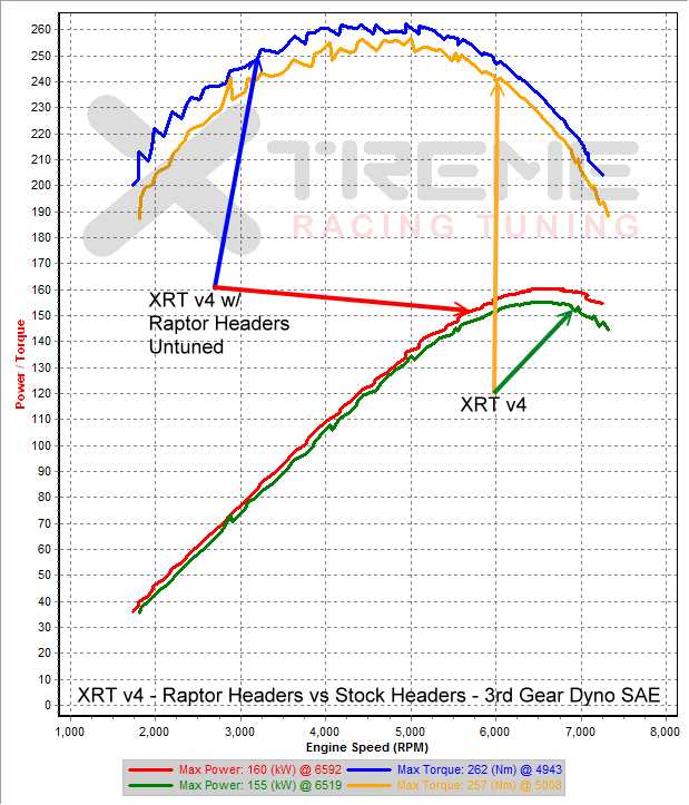

XRT v4 - Raptor Headers vs Stock Headers - 3rd Gear Dyno SAE.png (48.84 KiB) Viewed 20185 times
