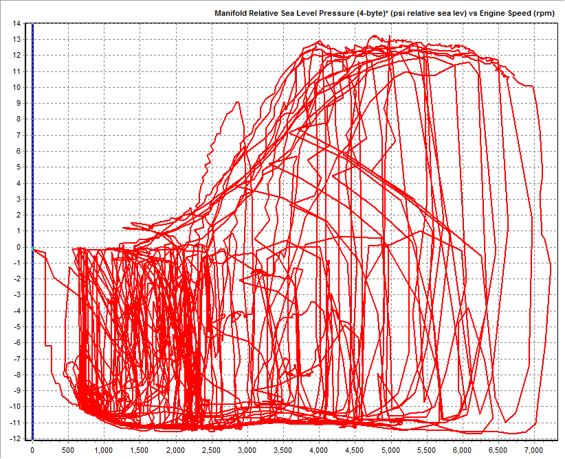

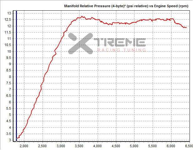

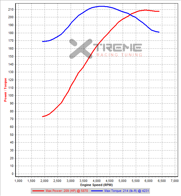

Stock Data
Posted: Tue Feb 12, 2013 8:12 am
Owner: Lynden
Rom: A2TB100U
Tyres: 225/40R18
Car Weight: 1395kg
Tuner + Passenger weight: 150kg
Total Weight: 1545kg
Perrin CAI
Cat Back Exhaust
Stock Boost Curve.png (56.6 KiB) Viewed 24293 times
Stock 3rd Gear Dyno Boost Curve.png (17.68 KiB) Viewed 24262 times
Stock 3rd Gear Dyno SAE sm=v2.png (21.27 KiB) Viewed 24262 times

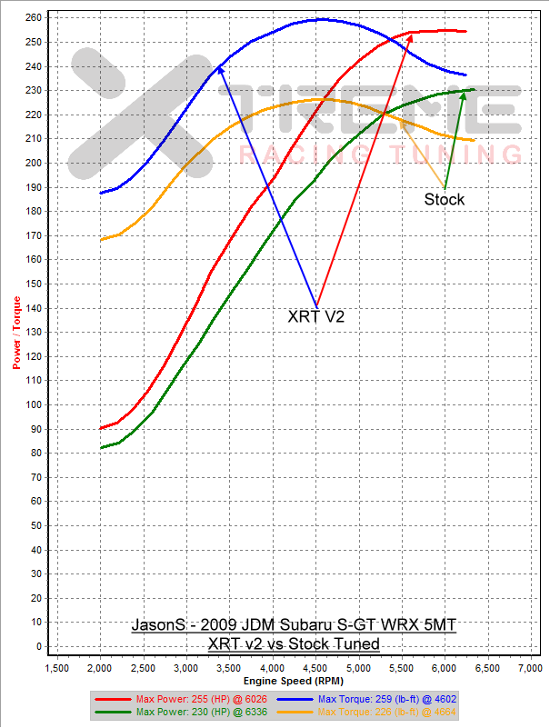

JasonS - 2009 JDM Subaru WRX 2.0 S-GT 5MT - TS IHI VF47 Tuni
Posted: Sat Jan 24, 2015 10:47 pm
Owner: JasonS
Rom: A2TB100U
Tyres: 225/50R17
Car Weight:
Driver Weight:
Tuner: kg
Total Weight: 1741kg
100% Stock
XRTv2 vs Stock - 3rd Gear Dyno SAE.png (48.59 KiB) Viewed 23399 times

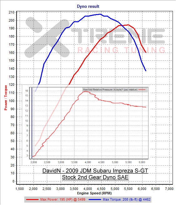

DavidN - 2009 JDM Subaru Impreza GT
Posted: Mon Feb 15, 2016 3:37 pm
Stock 2nd Gear Dyno SAE.png (57.95 KiB) Viewed 22793 times
