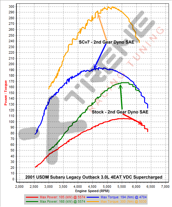

Stock vs SCv7 - 2nd Gear Dyno SAE
Stock vs SCv7 - 2nd Gear Dyno SAE.png (78.36 KiB) Viewed 20326 times

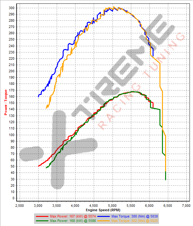

SCv7 2nd Gear Dynos SAE
scv7 2nd Gear Dynos SAE.png (58.93 KiB) Viewed 21084 times

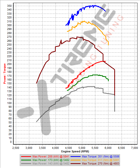

v8 Dyno Stats
1st_2nd_3rd - Gear Pulls Dynos SAE.png (52.62 KiB) Viewed 21075 times
