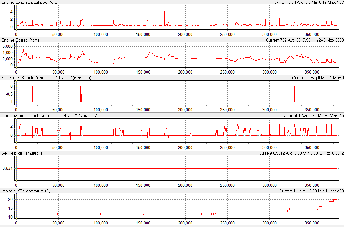

Stock Criticals.png (25.96 KiB) Viewed 5533 times

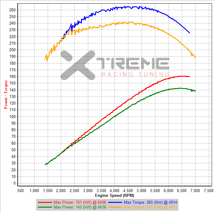

v3 3rd Gear Dyno IAT=16-15_38-25 .xml.png (35.4 KiB) Viewed 5521 times
Higher reading is for IAT= 15.5C. The other is from IAT=38C to 25C.
