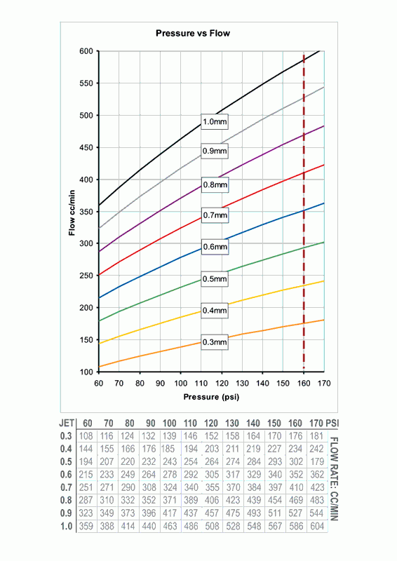

4) Subtract your peak boost pressure from the system running pressure on the chart and find the appropriate jetting range.
WI Jetting.gif (31.94 KiB) Viewed 11802 times
For the example being discussed we want to target 20% which would be 640cc. We will then need to add 10% for the pumping losses, so we are looking for 640cc x 1.1 = 704cc. We also know our peak boost is 30psi. The new Aquatec pumps run at 165psi, the older Shurflo pumps at 125psi. We have a brand new HFS-6 installed in our test car so we use the 165psi starting point.
We start at the 165psi line, and subtract our 30psi boost pressure. This means we need to look at a phantom line of 135psi. So we have our 704cc target, we look down the columns and estimate that between the 130 and 140 columns 704cc is going to fall around…….wait, it’s off the chart. We need to use two jets. So, we split the 704cc in half and see that 352cc falls between the 130 and 140 columns right right between the .6mm and .7mm jet range. In this instance we will pick two .7mm jet as we can always trim the flow down with the gain (and trim on HFS-6) functions.

IMPORTANT NOTE: It is best to test your jetting into a container and measure the flow. Since every build and configuration is different this will be your best measure of the system performance.

From the chart we can see we will need 3 jets to get the job done. So we look down the 130psi line (165-35 peak boost = 130) and find the 550cc for each jet falls just above the 1.0mm jetting. We are at the limit of the system and jetting at this point, but the system should work OK. The best test to see your actual flow is to measure the flow into a container through the system.

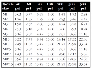

1 GPH = 63CC/MIN
GPH jets are calculated at 100psi. Since most systems vary the pressure to the jet to vary flow it’s easiest to use a chart to find your actual GPH jetting rate.
M Nozzle.jpg (89.12 KiB) Viewed 11802 times
Even though your pump is rated at 250psi, in reality it probably never injects at that pressure, especially with bigger nozzles. Use 150-175psi for realistic numbers when estimating what jetting you may have now.
Notice that the M nozzle chart is not linear; it is a square function. So the jump in flow from 100-200psi is not the same as the 200-300psi flow change.
