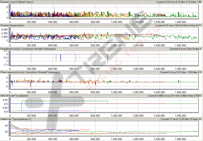

Stock Criticals.png (181.23 KiB) Viewed 33784 times

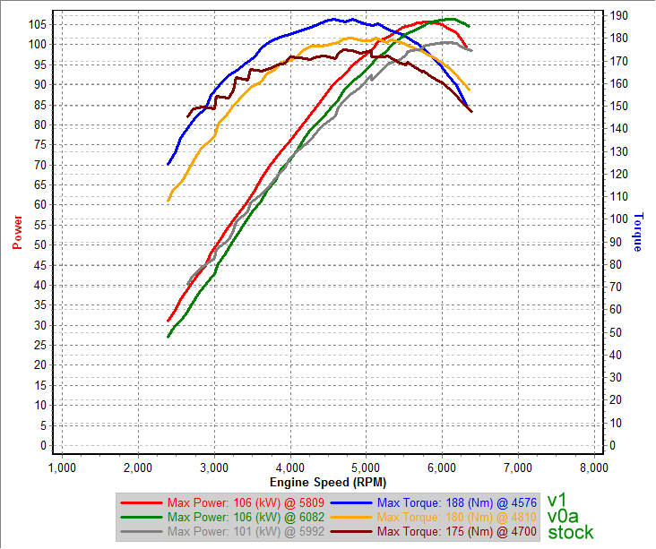

HyRax wrote:v1 ROM update
Tonight I did some formal lead-foot tests of the v1 ROM.
Hoooo-ly crap...! The car is on fire! Who'd have thought there was so much untapped power in the 2.5i?? With NO MODS???
The car actively pulls and powers on and on and on, all the way to redline with only a slight softening of puff as you pass 5,000rpm. Under 4,000rpm, the car was still perky from the v0a ROM, but v1 really took this to the next level above 4000rpm with the tweaks in timing and fuel.
I finally found myself a good, safe road to do pulls on that wasn't a highway, so I re-did my stock and v0a pulls to maintain consistency between each ROM release. Again, when I went back to the stock ROM after being tantalised with v1, it felt downright horrible. It was so laggy I felt as though I was driving an untuned WRX with a monster aftermarket turbo. I couldn't believe just how much extra throttle I was putting in to compensate for the lag under the stock ROM - all without realising!
While the car felt awesome, there was some pinging which was the result of Edward exploring the upper limits of changes. The next ROM, v2, will go back to the more conservative v0a timing and introduce some changes to the bottom end as Edward is not happy with what he saw there in my v1 pulls tonight from a fuel perspective.

The v1 ROM was amazing fun, Edward. Shame about my low-quality fuel causing some pinging, but once I change stations hopefully this problem will work itself out. Thanks to your work, I'd have never known that my local BP was supplying low-quality fuel. Once I test and confirm another BP station is supplying better fuel, I'll write into BP to complain about the first station.
Results should now be more consistent with a new set road to do my dynos on too. Re-did all my dynos on stock, v0a and v1 ROMs for Edward last night. Edward tells me that v2 will return to more conservative timing for now to start examining other areas for improvement.
I'm really hoping we can return to maintaining those levels of power by the end of all the tuning, though, because that was fun! :)
It just goes to show that Edward can perform magic even with a lowly 2.5i. He's been worth every dollar spent!
v1 Stats
v1_v0a_stock 3rd Gear Dynoes-rpm.png (27.63 KiB) Viewed 33760 times
v1 Dyno Runs IAT=18.5C - Pulls1_2_4.png (23.25 KiB) Viewed 33759 times

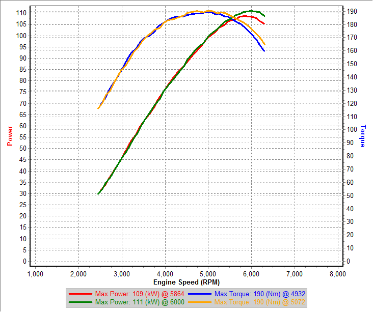

v3 Stats
v3 3rd Gear Dyno-rpm IAT=19-20.5C.png (21.09 KiB) Viewed 33754 times
v3 times.png (1.91 KiB) Viewed 33754 times

HyRax wrote:v3 ROM update
This was a very nice update. It was up to me to determine what Edward had changed in this ROM and one thing stuck out very quickly - the bottom-end is much stronger now. Fuel comes on very early and I attain quite high acceleration on very little throttle.
As a typical example, let's say you were high-geared and low rpm, eg: 4th gear at 2000rpm. On the stock ROM if you put your foot down flat to the floor, the tach very slowly starts to raise but the speedo doesn't really budge for another 3-5 seconds. Now I can put in less than 50% throttle and the car will pick up 5kph in about 2.5 seconds in 4th gear from 2000rpm. Useful in day to day traffic? Of course not, but it's a good indicator of how much more responsive the engine is at the bottom end.
In sensible gearing, the car picks up very quickly now. It's easy to hoon around and get to 100kph without even getting close to getting flat to the floor. of course power-runs will still require you to go flat-foot, but the majority of the power is delivered at the top of the pedal now, and I like it. Flat-footing it barely adds anything to the acceleration force you've already got.
1st is very strong now making it a doddle to get off the line as before, 2nd gear feels a bit stronger than it did in v2 and remains my favourite gear, but now that third is a lot stronger than before, I can easily take more corners in third without feeling like the car is about to lag and require a drop to second. The new bottom end allows the car to build up from low rpm quicker than before and get back into the meaty sweetspot of rpm nirvana. In a typical long left sweeper, the car just felt magical powering through it in third.
Where power used to come on at about 3,000rpm, getting meaty at 3,500-4,000rpm, the car now starts to come onto power at 2,600-2,700rpm and is in the sweetspot from 3,000rpm. The car powers onto 5,000rpm where it starts to lighten up a bit but it still gets to the redline pretty quickly.
One of the little differences I found in this release was the fact that I could actually feel myself being pushed back into the seat a bit for a change. Before you just more or less floated in your seat with a depressive force here and there, but now you can actively feel yourself being pushed back into the seat instead of it just being a comfortable, but laggy affair under the stock ROM.
In casual driving, 1st to 2nd gear changes were still a touch lurchy, but all other gears were fine. In hard accleration, all gears were silky smooth. In slow stop-start traffic, I found 1st gear still touchy, but more controllable and I did not need to rely on extra clutch action to control the extra throttle like before. As a side note here, when the car is cold, the car is lurchy in all gears, but once the car has warmed up, things are fine after that. I usually drive no harder than 3,000rpm for the first 10 minutes of driving to warm the car up anyway.
In high revs, gearing down actually felt and sounded more sympathetic to the car - it doesn't sound like it's simply revving its guts out anymore - it sounds much "cleaner" now, so now coming down from 3rd to 2nd is easier, but as I said before now I don't even need to take 2nd - third will climb back sufficiently now. Even letting the revs get down low enough that if you did take second, the traditional bogging down is near-eliminated because the car can quickly get itself back into power territory.
On the economy side, I've now racked up just over 200kms on this tank and the estimated distance-to-empty still only says 380kms! That's great considering how much hard driving I've done on this tank in a short time.
As you can see from the logs in Edward's post above me, compared to stock, he has manage to extract an extra 10kw of power and 15nm of torque overall. Remember that my car has had zero modifications of any sort in the engine department. It may not sound like much, but a 2.5 litre N/A engine, I think that's pretty good.
