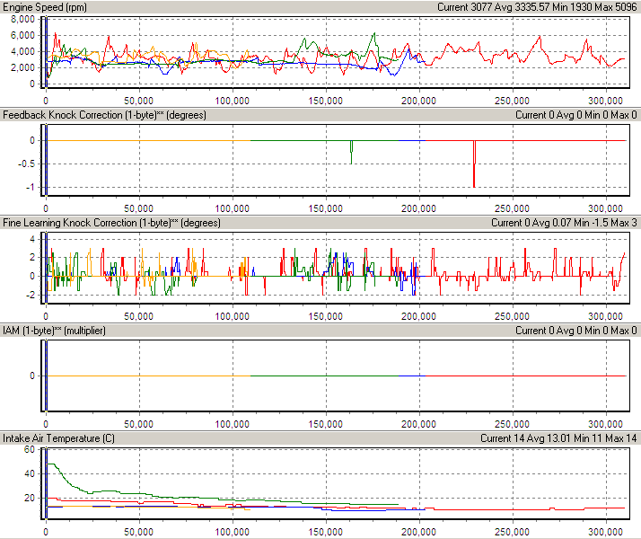

Critical Stats.png (20.45 KiB) Viewed 5221 times

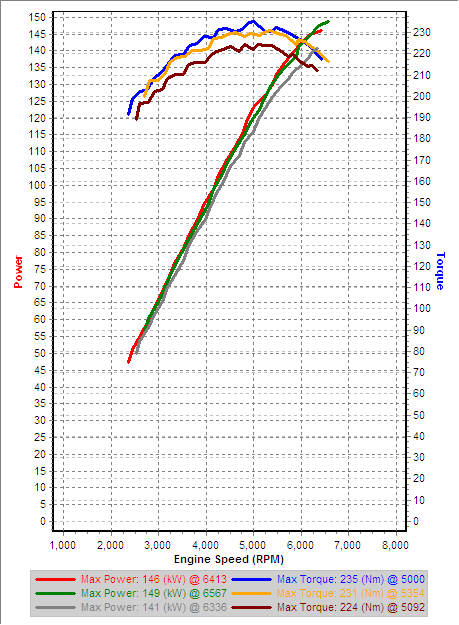

Stock 3rd Gear Dynoes @ IAT's = 15C to 22C
IAT= 15C to 22C
Stock 3rd Gear Dynos.png (19.6 KiB) Viewed 5199 times
