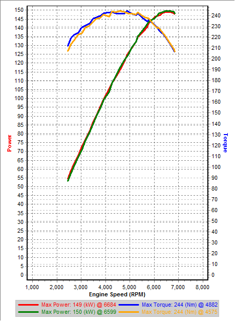

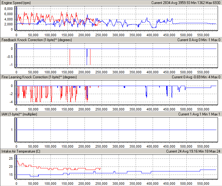

All dyno'es are based on RPM.
Stock 3rd gear Dynos Combine
Posted: Sat May 21, 2011 1:47 am
Stock performance critical stats.png (19.89 KiB) Viewed 11568 times
Stock 3rd Gear Dyno IAT=19_20C IAM=1.png (17.72 KiB) Viewed 11568 times

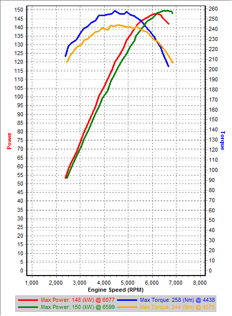

V0 Dyno Stats
Posted: Sat May 21, 2011 11:34 am
v0 3rd Gear Dyno IAT=17C Combine.png (18.04 KiB) Viewed 11550 times
v0 IAT=17C vs Stoc IAT=19C 3rd Gear Dyno.png (18.45 KiB) Viewed 11550 times

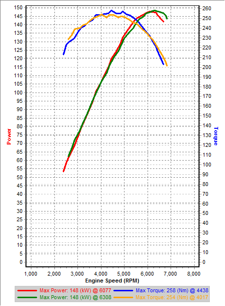

Posted: Thu Jun 02, 2011 9:02 am
v4 3rd Gear Dynoes IAT=16.png (17.77 KiB) Viewed 11511 times
v4 IAT=16C vs Stock IAT=19C - 3rd Gear Dyno.png (18.17 KiB) Viewed 11511 times
